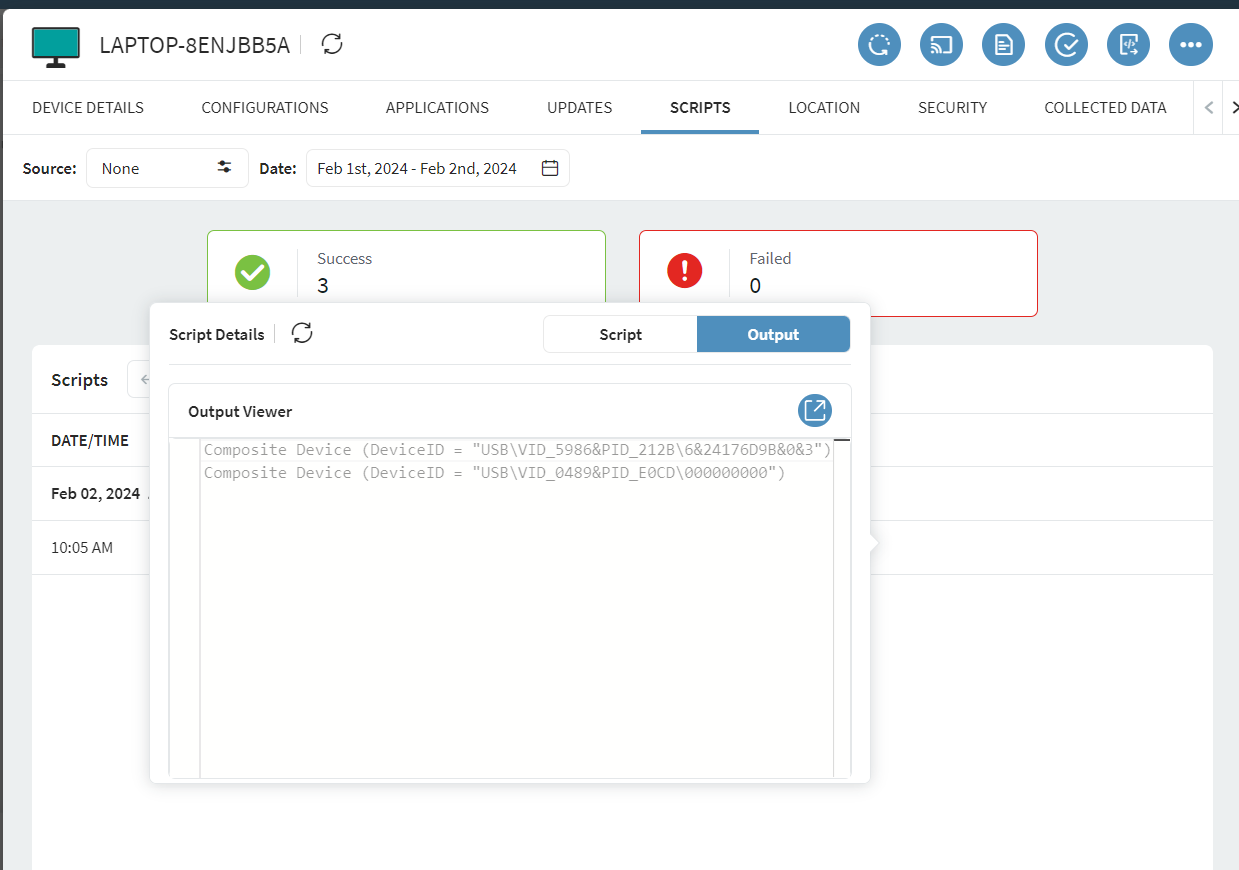

I have tried testing via send script  Get-PnpDevice -PresentOnly | Where-Object { $_.InstanceId -match '^USB' } | select-string "COM" and the results appear.
I also tried the custom data test as in the soti documentation https://www.soti.net/mc/help/v2024.0/en/console/reference/dialogs/devicesettings/custom_data__windows_modern.html, I created custom data to display bitlocker status c:\windows\sysnative\windowspowershell\v1.0\powershell.exe manage-bde -status | Findstr Conversion, and it works.
After I tried and looked at the script structure, I tried to combine it with the script to display the USB list. c:\windows\sysnative\windowspowershell\v1.0\powershell.exe Get-PnpDevice -PresentOnly | Where-Object { $_.InstanceId -match '^USB' } | select-string "COM". and it doesn't work.
the conclusion is that when I try send script Get-PnpDevice -PresentOnly | Where-Object { $_.InstanceId -match '^USB' } | select-string "COM" it works. How do I display the results in custom data?

I have tried the suggestions above but they still cannot answer my problem.
Is it true that custom data in modern Windows cannot produce long script results? I tried sending the script Get-PnpDevice -PresentOnly | Where-Object { $_.InstanceId -match '^USB' } | select-string "COM" to a modern windows device and the output appears. after that I tried to enter the script in custom data and it didn't work.
