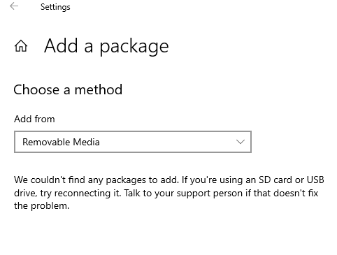

I discovered why I had received the previous error message - our antivirus software allows for not allowing USB drives. Once I allowed that on the machine I was able to go further. Now I am stuck at the screen shown below. I've tried inserting a USB drive with the package on it, and not with the USB drive inserted. Same message and no buttons to press to go further. Any ideas?

You dont have use that way to add/install the pkkg file.
Just copy and paste the pkkg file somewhere on your file system.
I recommend to run it as an admin.
I do the same when i add windows modern devices. I create the pkkg file -> copy the file to my
windows device -> run it as admin.

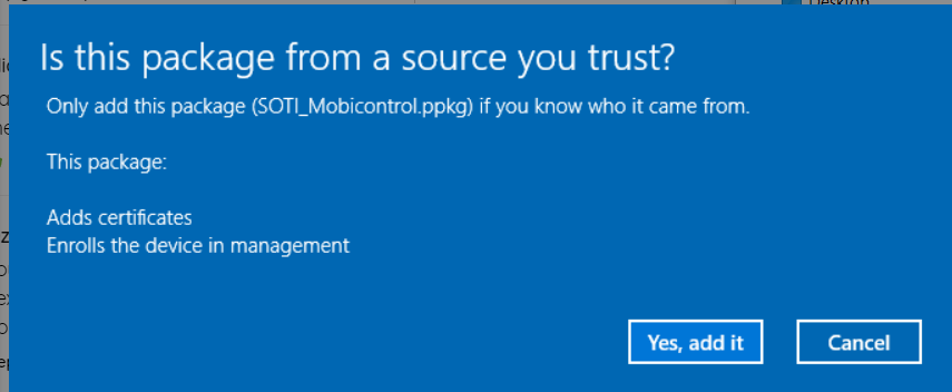

MP
Michelle Porreca
Cool ,,, Ran it using cmd prompt and Run As Administrator. I prompted me 'Is this package from a source you trust?' clicked on "Yes, add it".

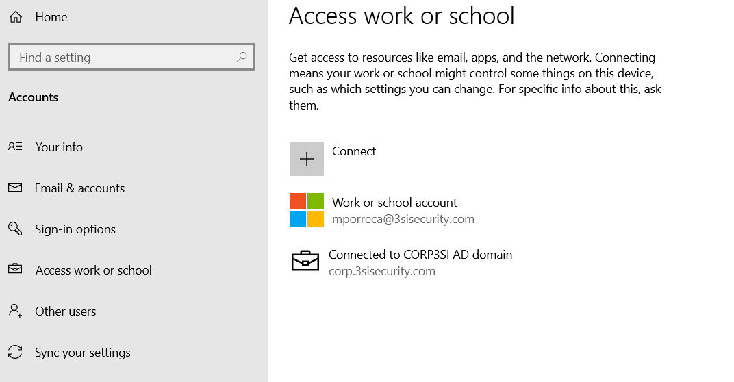

Now how do I know it installed the package?
OA
Ozan Acikalin
You can check it under your account settings. Under work and school you should see something like this:
You can click on that account and click on info. When you scroll down a little bit you will find the device sync status.
Just click on sync again and check the result under Last attempted Sync. If its successful then you should see the
device on your MC webconsole. If not then your pkkg file is not configure correctly.

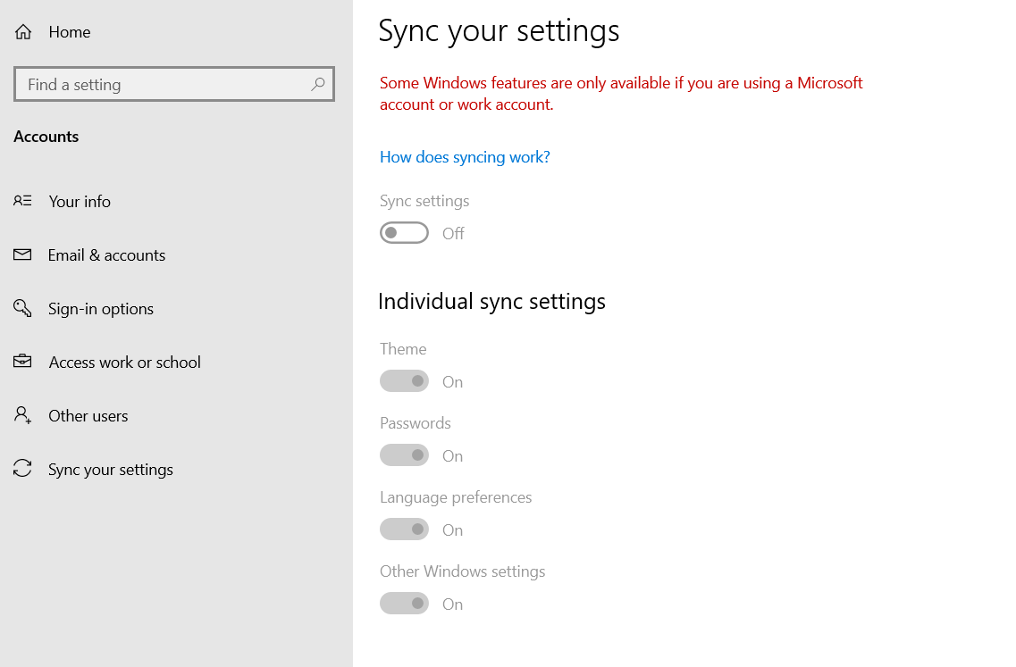

Michelle Porreca
Thanks for your help on this - greatly appreciated.
I do not see the package in account settings. And Syncing appears to be turned off somewhere because it is grayed out.
OA
Ozan Acikalin

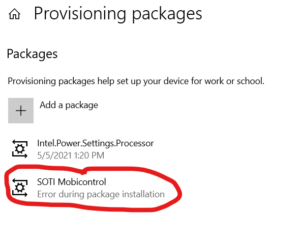

If the connection was not successful then it will not appear under access work or school.
But you can click on Add or remove a provisioning package. There you should find the package.
If thats the case then your pkkg file is not configured correctly OR you may have network problems.
Check if the necessary ports are open -> 5494/443 TCP outbond to your DS.
MP
Michelle Porreca
Thanks, It is showing an error on package installation, so I will need to go back to SOTI Support who walked me through creating the package - obviously something went wrong with it.
