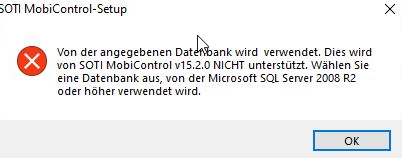

I'm trying to update from 15.1.2.1035 to 15.2
Unfortunately on installation I get the following error
Seems like it is unable to use the database, which is SQLExpress, which was installed together with Mobicontrol.
Server 2016 is installed.
Any idea?

Hi Guys
I've had the same error today after upgrading to SQL Server 2016.
Then I've recieved the strange error message with the question marks.
Then I've installed the SQL Server 2016 CU12 Update, you can find it here:
https://www.microsoft.com/en-us/download/details.aspx?id=56975
After the install of the CU, the MobiControl Update worked perfectly fine.
Hope this helps

are you able to run the Setup in English?
I had the first in German to and was getting some Funny or Stange error messages.
When the Setup is running with English i was getting other "Messages" during the Setup, what made more sense.....
Ew are runnning with Windos Server 2016 and SQL Server 2017 Express Release 21 (14.0.3335)

German:
??AO???---?????????CE????????????????Ä?????????????+?U?????H????????????
English
Please install SQl Server 2017 Cumulative Update 8 or later and restart the installation....
German:
Klicken sie auf "ja" um den Kompatibilitätsgrad automatisch auf Microsoft SQl Server 2008 R2 umzustellen
Englisch:
Press "Yes" to let installer automatically change the Compatibility level to Microsoft SQl Server 2012.

Hi Benjamin,
when you upgrade from 15.1.2 to 15.2 the Setup is not Updating the SQL Server Version.
i had installed on an empty Server the 15.1.2 Setup and tryed the Update to 15.2.
Result is the Same Error Message as you get (in German).
I think you must Upgrade the Existing SQL Server 2014 or older to SQL Server 2016 or 2017 Version.
English Message: (seems has been not getting updated to the new requirements)
The Specified database uses, which is NOT Supported by Soti MobiControl V 15.2.0 Please choose a Database Using Microsoft SQL Server 2016 or Above
Have Updated the test Installation to SQL Server 2017 with the last Built and Setup was running
https://www.microsoft.com/de-DE/download/details.aspx?id=55994
Edit :D
Then you must when you had upgrade to SQl Server 2017 apply the update to a newer version as relase 8
https://support.microsoft.com/en-us/help/4047329/sql-server-2017-build-versions
