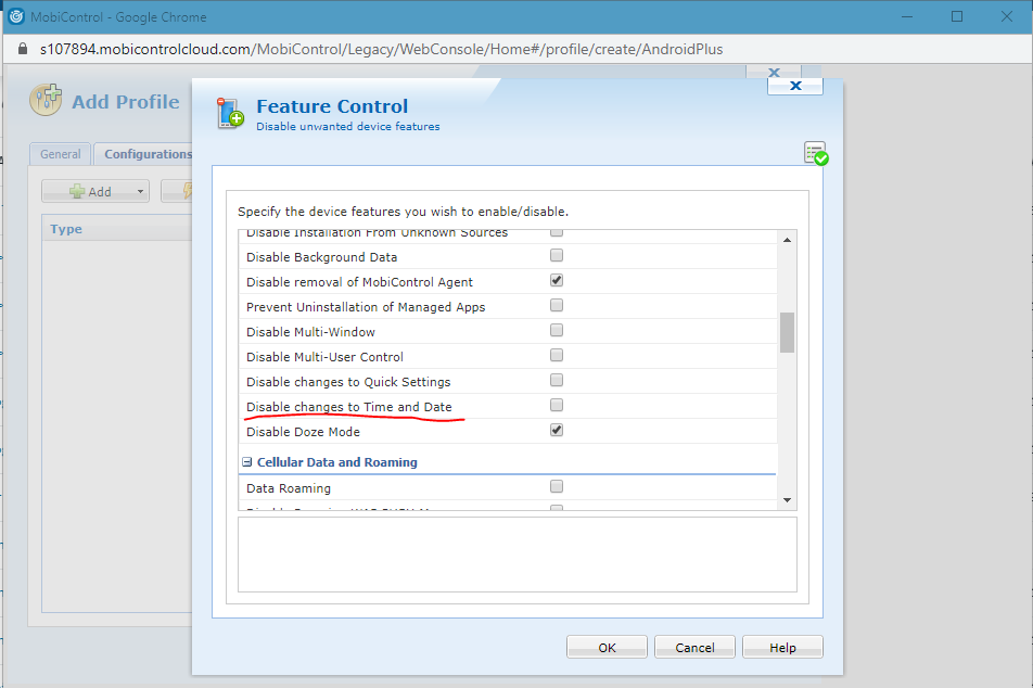

Hi, I would like to disable the time and date section on android plus. Our users are editing the time which links to an app we use thurs are getting wrong data.
I know in feature control there is an option but it doesn't show on our portal. I am using 14.4.8.1043
Is there a script I can run?

Hello Ben Anderson,
Thank you for your post, did you tried feature control profile to disable changes to Time and Date?
Let me know if this works for you.

Thank you but I do not have this option. I have seen this when I have googled the issue and have double checked the option but it isn't there.

JVMOD@SOTI
Hello Ben Anderson,
Please select Android Plus on the following window -

Hello Ben Anderson,

 My client is using AE for their enrollment.
I choose AE option, and i didn't find the same option in AE.
Is it possible to apply that Time Disable in AE enrollment?
