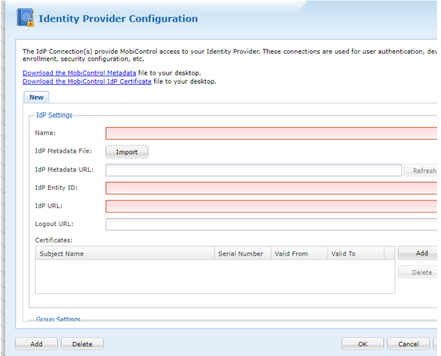

May I ask if you have tried the configuration here as below?
please refer to this link for the details of the configuration:
https://www.soti.net/mc/help/v14.5/en/console/reference/dialogs/globalsettings/identityprovidermanager.html

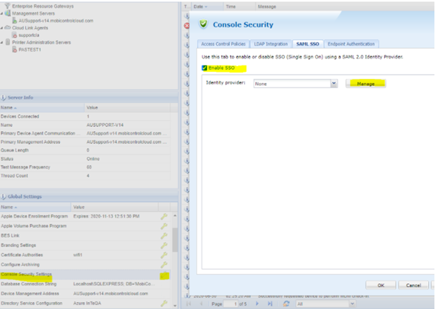

Can you please send the following two things:
1. A screenshot of the error message you had on SAML
2. A screenshot of the page like below:

Hi DRMOD@SOTI,
thanks for the reply. I made some screenshots and attached them, let me know if you need anything else.
