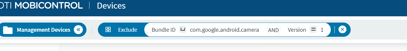

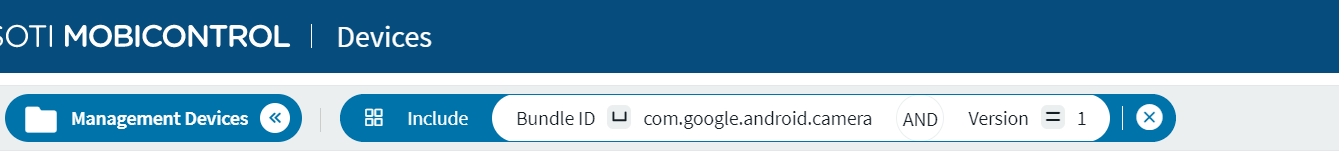

Thank you for your post, we do not have a direct method to find an answer for your use case.
But, you can use the search bar to find applications installed with version and all.
1. You can use "include" keyword to check if that particular app is installed or not with version number
2. You can use "exclude" keyword to check which devices do not have this particular with version.
Please let me know if this will help you.
