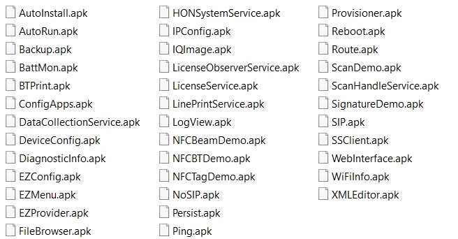

Using file synch to upload the files (PHOENIX-M..zip and Common ES..zip) to the devices CK75 (via SOTI MobiControl) then excuting a script to upgrade the firmware.
The problem is that the apps from the Common ES package will not be installed totally means some apps installed some others not.
Do you have a solution for that?

What files are in the Common ES ZIP folder?
