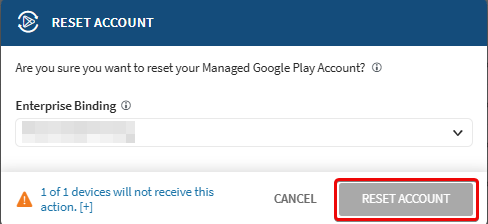

Hi there,
I'm working on resetting Enterprise Binding of the devices. The feature which SOTI introduced in v15.1.
Source:
Issue: Most of the devices got reset with the account while in some of the devices Reset button is completely disabled. I checked MobiControl app there is no pending action also Google Play Services and Play Store are enable.
Any idea on how to fix this without reenrolling the device?
Reset Account Prompt
SOTI Version: 15.5.2.1003
a year ago

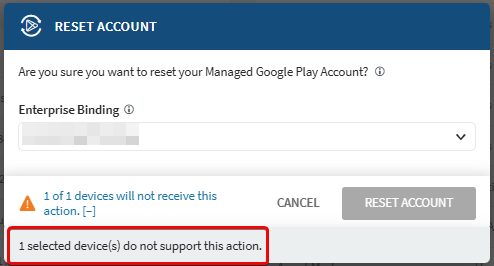

If you press on the blue message on the bottom left of your screenshot, what does it say?
R
Ravi
a year ago
Hi Rafael,
Thank you for the response.
It says "1 selected device(s) do not support this action."

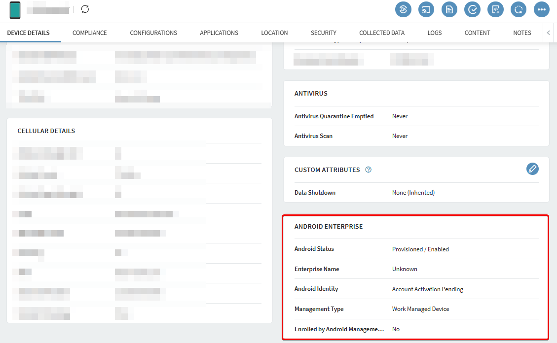

Please check then:
Are those devices the same model/firmware/enrollment as those which work?
Is the state for these devices in device details in following section "Android Enterprise" -> "Android Status" the same as on the working ones?
R
Ravi
a year ago
Yes.
"Android Enterprise" -> "Android Status" is as per the following:
Working: Provisioned / Enabled with Managed Google Play Accounts
Not Working: Provisioned / Enabled
The only difference on my end, i can find is that for online devices i could execute this action even with your state of the non-working ones, but on the offline ones i get the same error message as you.
So, even it sounds stupid to ask, can you ensure the relevant device is online when trying to do this?
R
Ravi
a year ago
I understood your concern.
The device is online and I'm also able to take a remote control.
In Android Identity it's showing: "Account Activation Pending" but there is no pending action. Is this cause any issue?
Image attached for your reference.
But as the account assignment is pending already this can also be the case for this issue. Is the device on same network as the working devices?
