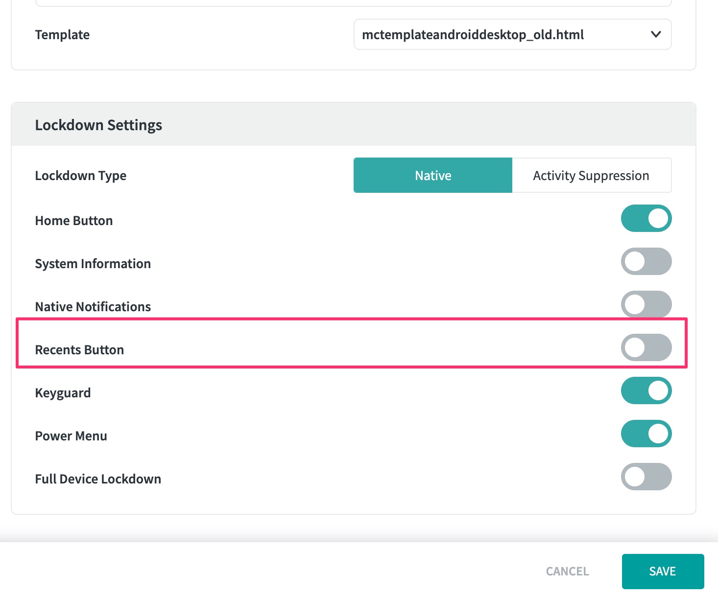

You should be able to enable the Recents button in Native mode within your lockdown configuration.This works for Android 9 devices and higher:

My apologies. You are absolutely correct.  I flip flopped the Lockdown types in my question.  In Kiosk Lockdown type "Activity Suppression" everything works as desired.  When we switch to Native Mode, to gain access to the Recent Button, we have an issue where clicking the App icon on the home screen "does nothing" after a soft or hard reset.  Sending device action 'Enable Kiosk Screen', restarting Kiosk Mode with a script, or revoking/assigning Kiosk mode all resolve the issue until the next soft/hard reset.
