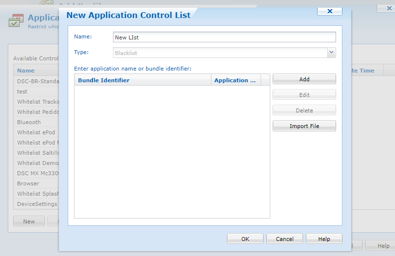

When creating an Enterprise profile and adding an Application Run Control configuration there is no option to create a whitelist.  The drop down is greyed out and not available.
Is there a reason for this?
If the profile type is set to Android Plus the whitelist option becomes available but is ignored when pushed to an Android Enterprise device as part of an Enterprise profile.

Hello DanT,
Thank you for your post, please share the screenshot of the profile.
D
DanT
Hi JVMOD,
Please see below;
- Create new profile - Type = Android Enterprise
- Add Application Run Control - New
As you can see it defaults to Blacklist and greyed out.

Hello DanT,
Thank you for your prompt response, we do not have Whitelist applications option for Android Enterprise devices.
Please try to use following script - enable_system_apps <bundle_id>
