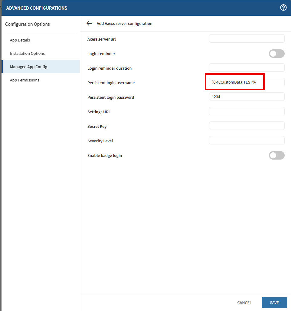

I have a question about passing custom data to a Managed Google Play app. The data is stored in a JSON file and is accessed using custom data settings. This works perfectly within Soti (e.g., Lockdown, CustomMessage, etc.).
However, as soon as we try to pass these values to a Managed Google app, it doesn’t work. I’ve learned that Soti plans to support this in v2026.
Do you have any ideas for how we could implement a temporary workaround?
Here’s an example to give you a better idea:

Of course, I tried what you mentioned, but only the macros specific to Soti MobiControl (%DEVICENAME%, %MODEL% etc) are passed to managed Google apps and unfortunately, custom data is not transmitted.
