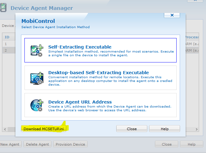

so under enrollment rules and device agent manager you can download mcsetup.ini,
my question now is how exactly do use it?
Because all provision methods dont use the file, right?
Self extracting executable has already all enrollment informations needed, same as desktop based enrollment and device agent url adress.

It would be challenging to include multiple MCsetup.ini files for one agent, because the setup files are 'Rule and Agent' specific. It is recommended to follow one of the above 3 methods mentioned for enrolling Windows device.

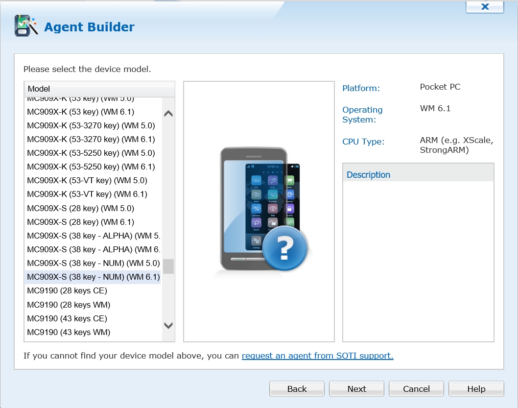

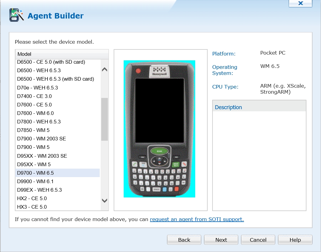

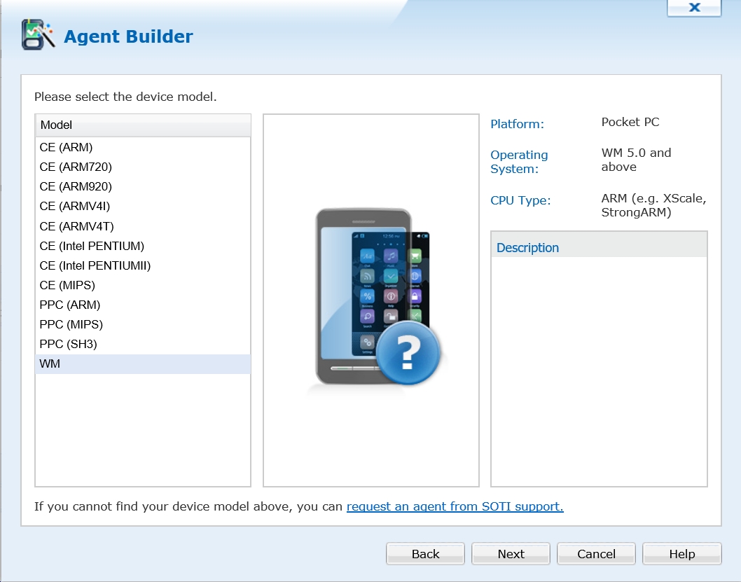

For generic Windows Mobile device agent, choose "Others" for Manufacturer in your Agent Builder Tab, and you should have option to select Windows Mobile  5.
For OEM specific Windows Mobile agent, choose the corresponding manufacturer and model supported, and there should be option(s) for different Windows Mobile version(s).  E.g. for Zebra and Honeywell devices, you can respectiviely find the following:

The MCSetup.ini file contains all the instructions required to connect to the MobiControl server, package to include in the configuration etc. If the device resets, the .ini file in the persistent storage helps to reload upon reboot.
This file is helpful if you have an agent already running on the Windows device and needs an instruction file to connect to the server or if you have any other methods of Windows CE enrollment (other than the 3 methods that you have posted on the discussion).
We highly recommend you to follow any one of the three methods for device agent installation when you are enrolling a device for the first time, as it includes the agent and ini file in it.
1. Self-extracting executable
2. Desktop based self-extracting executable
3. Device agent URL address
