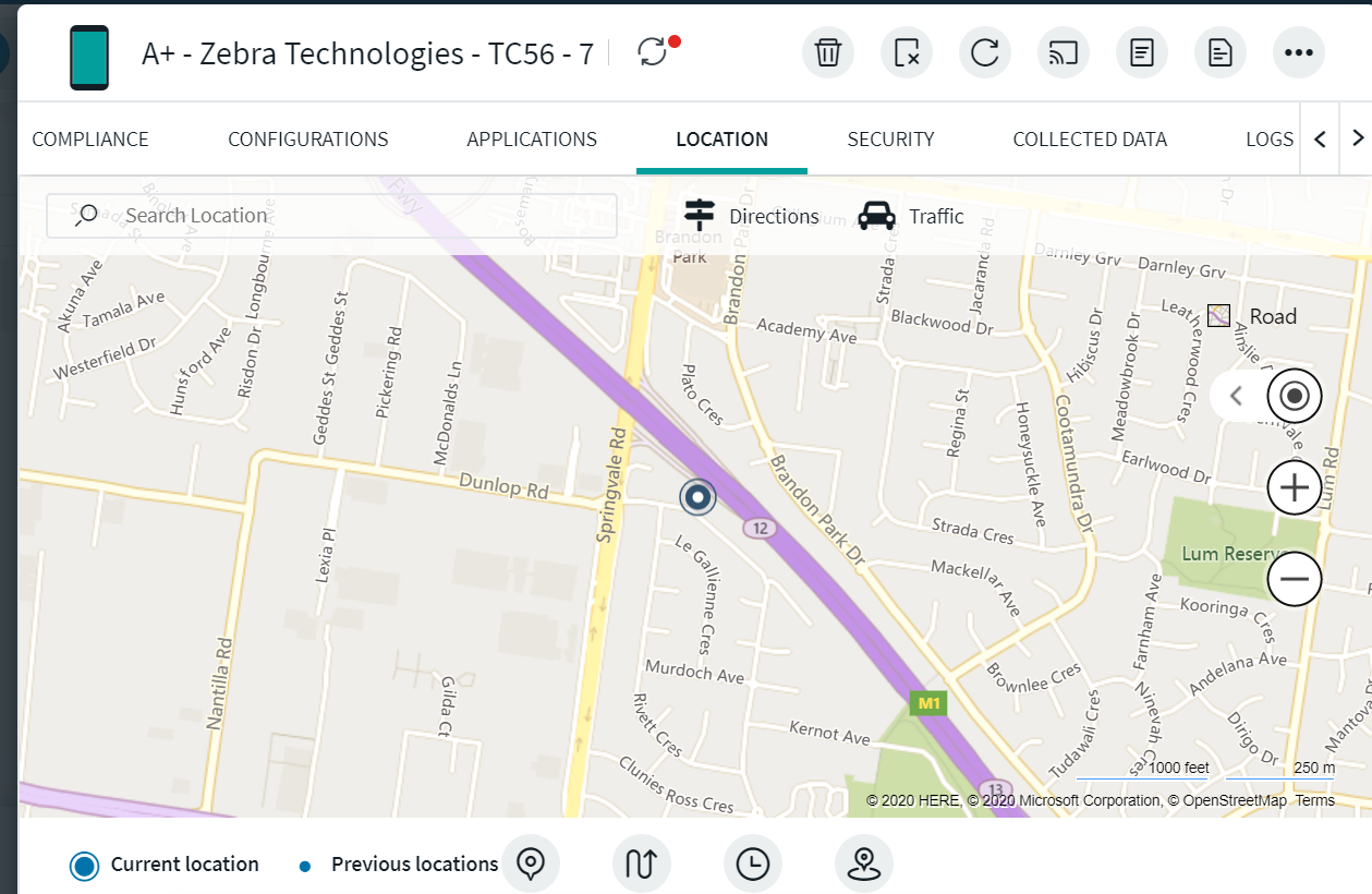

Thank you for your response, are you able to locate the device using MobiControl web-console?
Regards
GP
Gareth Perry
no but i think we have a wider issue. We have a rule set up which collects the location history every 30 minutes. It is set against all devices. It is currently 15:44 our time and i can see that the last time most of the devices gave their location was 14:00. i can also see that on the logs for these devices nothing has been recorded / logged since 14:00
