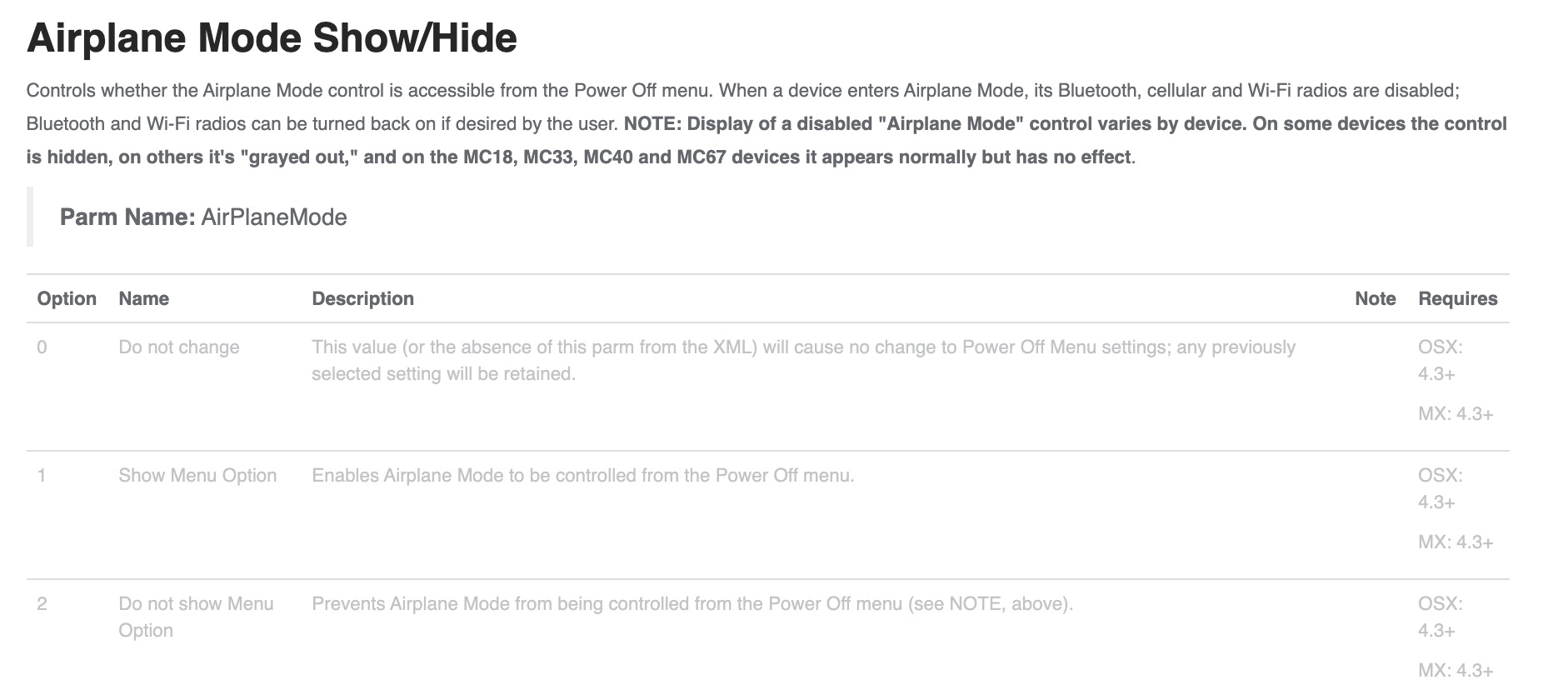

Besides the Feature Control option there is also an exposed configuration available in MX. With that said, the TC25 does have a purposefully limited number of MX configurations so it may not in fact support these options. I toggled the TC20/TC25 option on the TechDocs site and it does appear to be grayed out.
