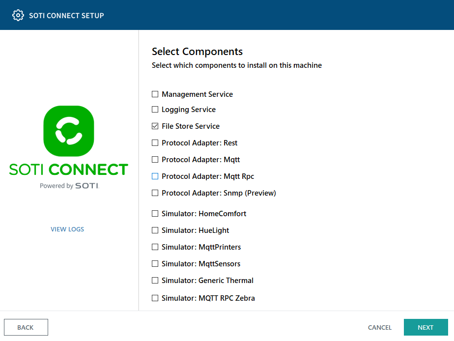

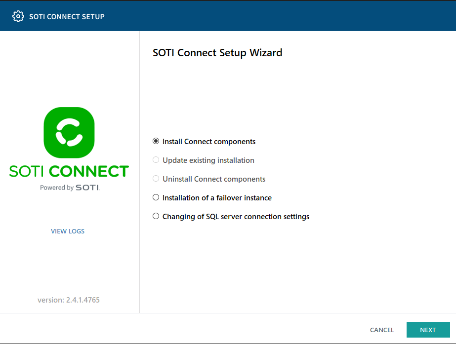

It is possible to have only the File store installed on your 2nd server. You will have to make sure that all the files and folders have been deleted from the server from the previous SOTI Connect installation. If there is no existing data from the previous installation then you should see an installation window like the one below.

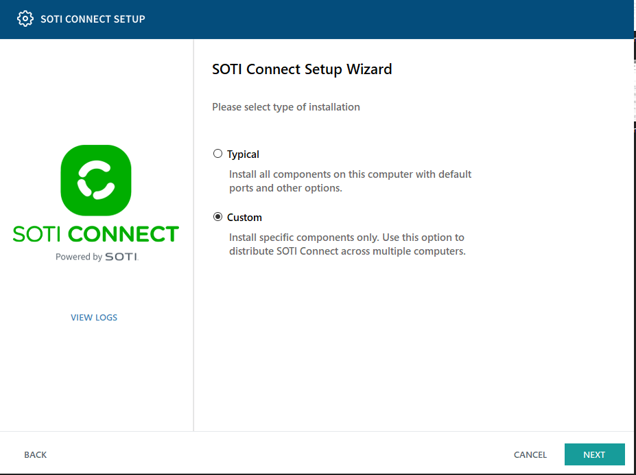

Please select the 'Custom' type of installation
On the next page, you will be able to select just the File Store Services and uncheck everything else. then hit next and proceed with the rest of the installation process.
