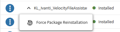

In [Configuration] tab click on the [Down] arrow to expand the [Profile].
Then select the Three Dots on the left and click the "Force package Reinstallation".

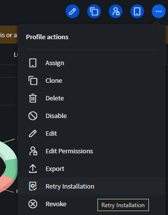

Afik there's no script for it but I assume you need to do it via script as multiple devices failed.
To try to fix them in one go, you can go to profiles (not on device details), search for the relevant profile , press three dots and choose "retry installation":
It will then retry the installation on all failed or partially installed devices.
BUT keep in mind, if the profile contains more than just the package, everything else will also be reinstalled (thats why i recommend to split them up).
