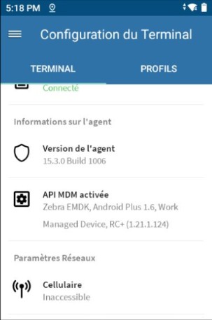

Hi Jean,
I am not sure if I can get a full picture based on your incomplete answers posted.
Could you please check what active MDM API's are reported  for your devices in the web console or in the Device Configuration tab of the device agent?

Hello Raymond,
3 years ago
Hi Jean,
Thanks for your informative screenshot, which confirms that your device is running a generic Android-Enterprise device agent in managed-device mode.  I will just assume that your other Zebra and Honeywell device models have their device agents showing the same "Work Managed Device" active API item.
As I don't know which exact models you are using, nor having access to such device models to carry out any tests,  I can just comment in the general sense.
Most Android device OEM  have their own proprietary mechanism and infrastructure to download firmware upgrade images for supported devices.  Most only support upgrade, but not downgrade.    The latest Google Android Enterprise infrastructure provides standard MDM API for any compliant 3rd party MDM solution like Soti to manage firmware upgrade in only some limited way.  There is no option for controlling downgrade, nor is there any STANDARD script commands/arguments defined to control the upgrade/downgrade process.    Thus, you can only use the MobiControl script command/profile mentioned in my earlier post to limit upgrade process IN THE FUTURE, but the downgrade process (if available for your device models) required for your current problematic devices has to be done manually.
Regarding the downgrade process, it can be complicated and may vary between your different device models. Your previous posts already indicated that your Webview used  is  the "Android System Webview" shown in devices Settings.  I suggest you to check in EACH of your different problematic device models whether you can SUCCESSFULLY disable the "Android System Webview" module, and download any "Android System Webview" module from Managed Google Play store associated with the MANAGED Google Play Account of your AE device enrolled. You could also test if Velocity or other apps can function properly using the Webview/Webkit in the Chrome browser app (as hinted in the web-page of Ivanti) if you have the "Android System Webview" disabled.   The rationale behind is to TRY decoupling  the Webview module to be used from the one already included in the firmware image released by the OEM manufacturer, as it is often important to upgrade firmware to fix security or other critical issues. You might be able to find apk of older version of "Android System Webview" or Google Chrome from the web (though you might also need to check.confirm the apk has not be tampered with to include any malware).  Such older but proven version compatible with your Velocity app can then be used if the decoupling mentioned above is possible.
In any case, please do sufficient tests for EACH of the device models involved.  Confirm that the flow is working fine before mass-scale deployment for remaining production devices of the SAME model & firmware version.
