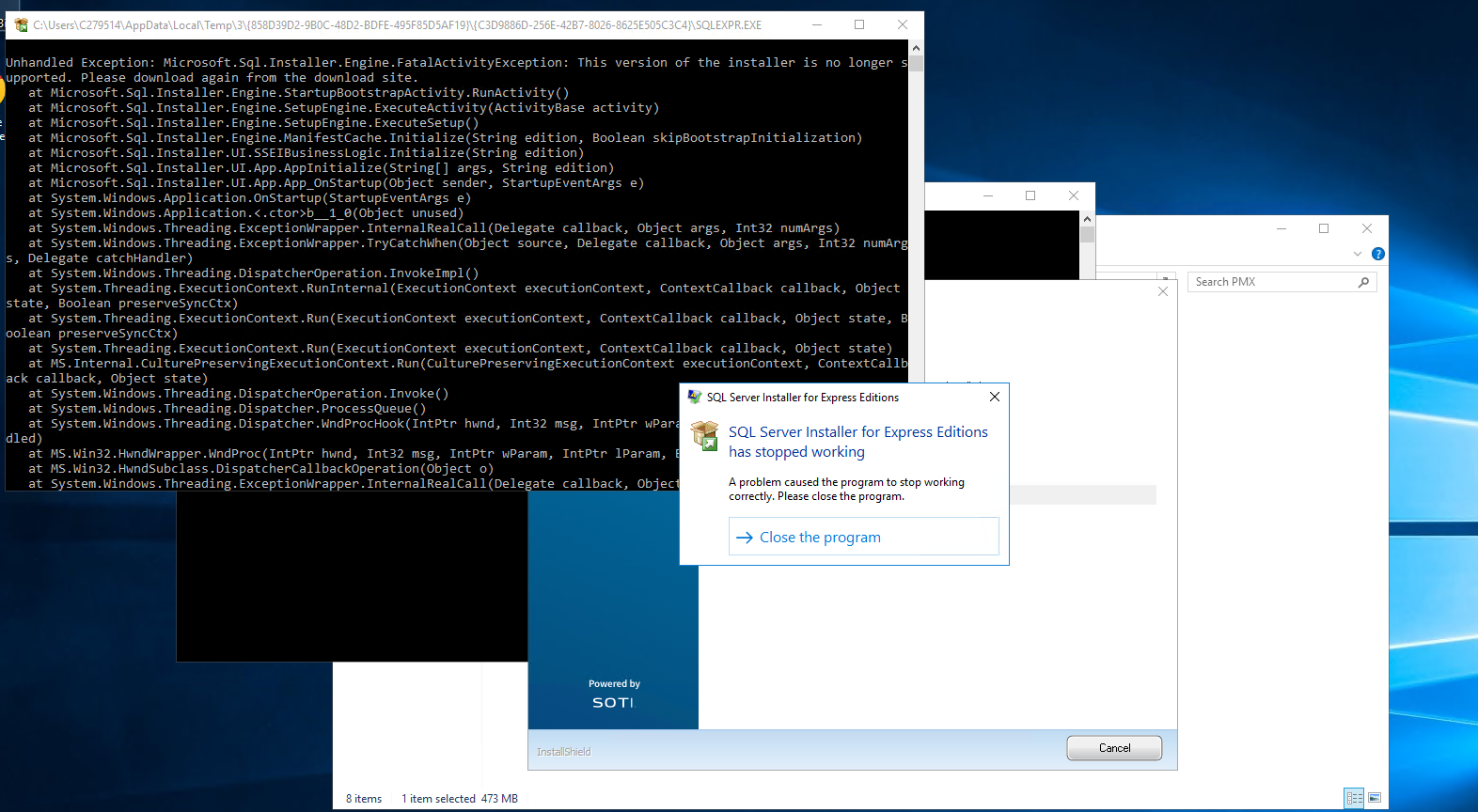

We are installing Soti MobiControl console version 15.2 on a Windows2016 server. The installation crashes while trying to install SQL Server Express 2016. The error logged is "This version of the installer is no longer supported". I have already investigated a little bit about the issue. It looks like the problem is caused by the fact that the bundled version of SQL Server included in the MobiControll installer is the ServicePack2. In fact, I have tried to preventively install the ServicePack3 version and it looks like it works. The incompatibility, most likely, is related to the SP2 version of SQL Srver Express 2016 with one the latest Microsoft security patches. Actually, the Windows Server 2016 I'm using is updated to August2022 bundle.
Unfortunately, being a production environment, it's not possible to install any different version than Soti MC 15.2 and, of course, it's not possible to remove any of the patches that could cause the issue.
I have already opened a case to SOTI support and we're waiting for a feedback, but I was just wondering if anybody else faced the same issue and how it can be resolved. The easiest way would be to be able to temporarily disable the SQL Server support check at Windows level (by changing a reg key or by using a specific policy?), but any suggestion would be more than welcome and appreciated.
