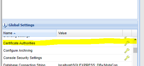

I am attempting to configure SOTI to issue certificates to be utilized during 802.1x authentication. I am unable to create a certificate template within SOTI which would be a requirement to issue these certificates from our internal CA server via SCEP. I found a guide located at this url: https://www.soti.net/mc/help/v15.1/en/console/system/certificates/add.html , however this seems outdated as there is no "Certificate Authorities" section with a wrench next to it at the stated screen. Is there an updated guide to configure MobiControl cloud for this purpose?

You must be able to see a wrench icon as mentioned in the link shared by you and I am able to verify on 15.1 version and attaching the screenshot too.

Kindly confirm your exact Mobicontrol version along with build no and also attach a screenshot of the section under global settings.

I'm signed in with an account with an MC Admin account and I have tried several browsers and incognito mode. The below is all I am seeing in this section. Any ideas?
I was unable to upload the image to your forums so it's on imgur. Here's the link https://imgur.com/a/xXZfgxZ

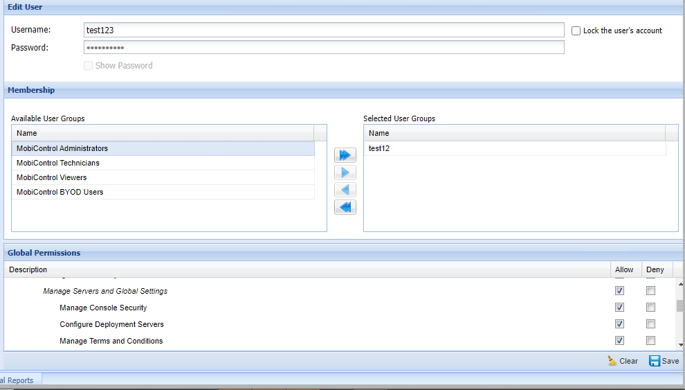

  1. On the All Platforms tab, select the Security tab.
  2. Select the Manage Users option from the left pane of the console and click on your user user name though which you logged in
  3. You will see a global permission section and there you need to see if you have all permissions are allowed or not(mainly under gloabl settings permission subsection) .(screenshot is attached for your reference)

Jason Popp
Those settings look good for the user group "MobiControl Administrators" , the IDP Group "MC Administrators" and the user "Administrator". I am signed in via SOTI Identity as a user with MC Admin access so I'm sure I would fall in to one of the above groups.
