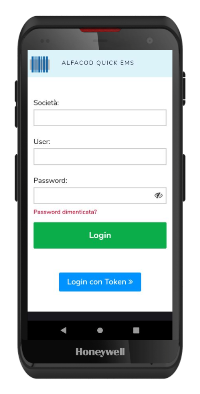

If i dont enable the kiosk mode, the device show me the status bar, but if i try to enable the kiosk mode, Soti SURF works as a FULL SCREEN and the status bar disapear.

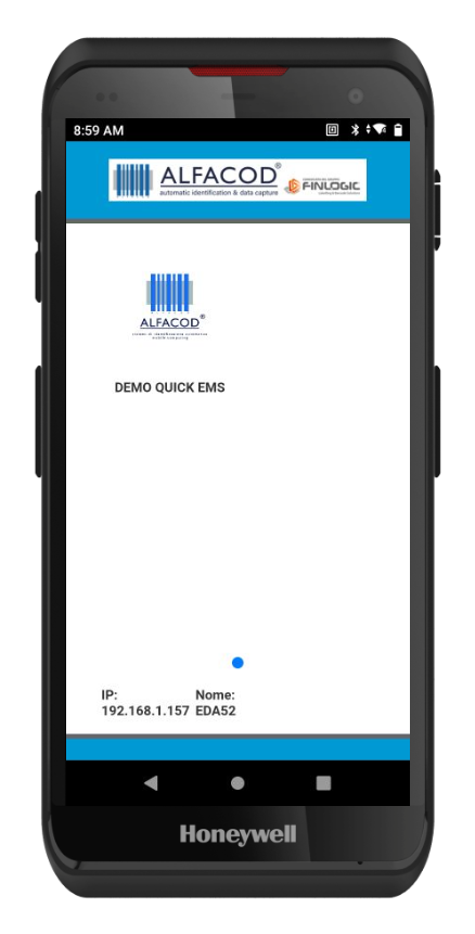

I'm using also Lockdown mode, and here the status bar it's showed.
LOCK DOWN
SOTI SURF KIOSK MODE
