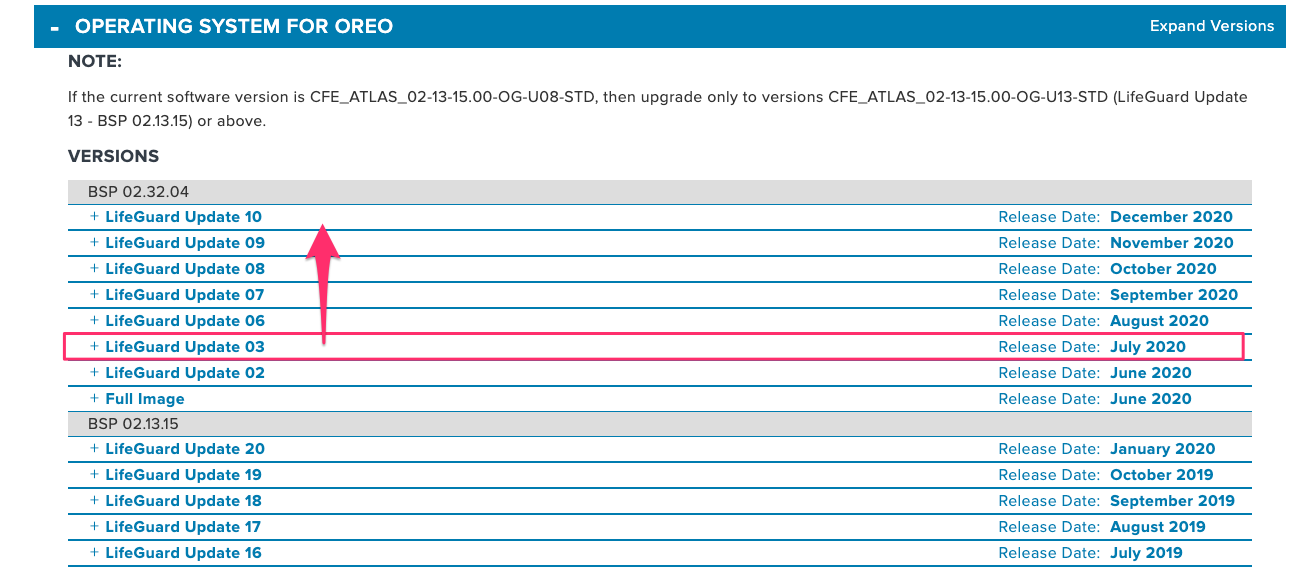

Added in MX 10.1 so it should be possible to deploy to your devices as a StageNow generated MX XML + mxconfig script.
The devices will need to be on LG3 or higher of the latest BSP in order to have MX 10.1 support so you may need to update them first before the setting will apply.
