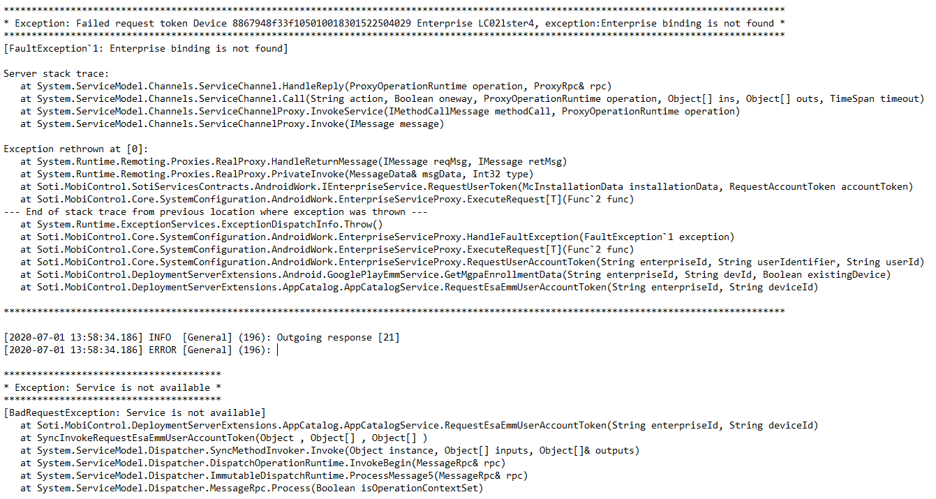

The problem is the device agent is stuck in the step to get a Google Account.
On the server we got the error message: Error message received from device (Managed Google Play Account Status:'EMPTY_TOKEN Got response but there was no token!')
In the verbose logs there is this:
verbose logs
But the Enterprise binding is present on the server:
bindings
In our add device rules we are using the BMW Group binding.
My first test was to create a new binding, the BMW MDMI and use this binding in a new add device rule to get a new Enrollment ID.
So we enrolled a second device and entered the new Enrollment ID manually and the whole process was running without the binding error.
Did you encounter some of these problems too after the upgrade or do you have an idea what happend there?

Hi guys,
I opened a ticket to Support.
The problem was in the Soti backend. Our registration code hasn't been successfully updatet for the Enterprise Binding.
Support and backend team managed to change our registration code.
Enrollment is running smoothly now.
