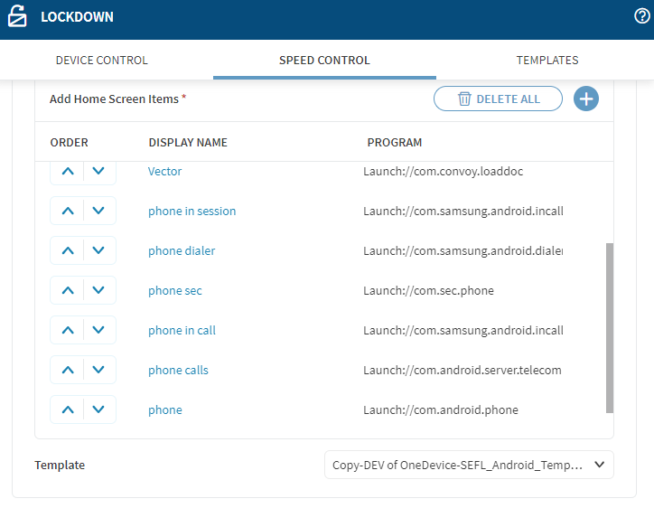

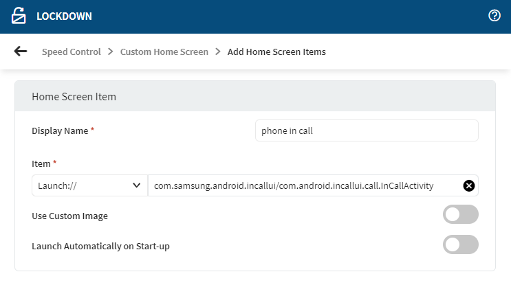

thanks guys i have added them all here:
along with this one:

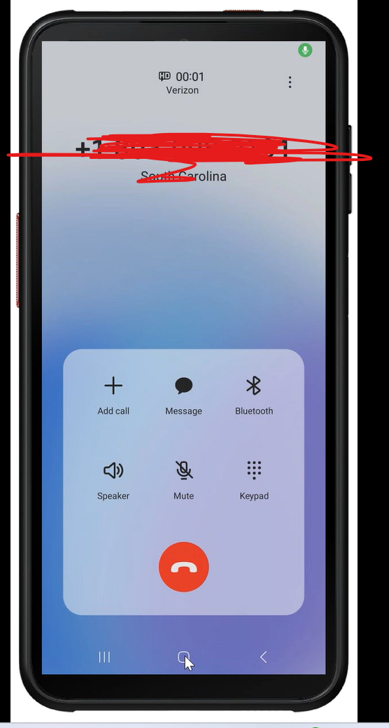

and all are saying package not found when tapping on the phone icon using that bundle id except for the dialer bundle id, the phone dialer comes up but the not the in call session itself:
