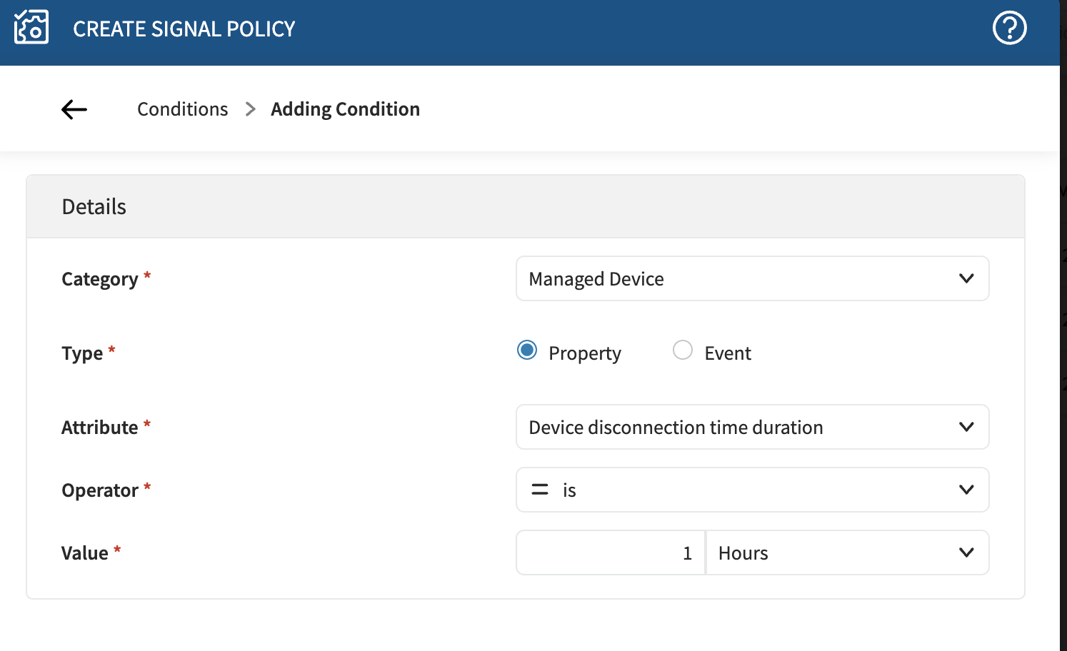

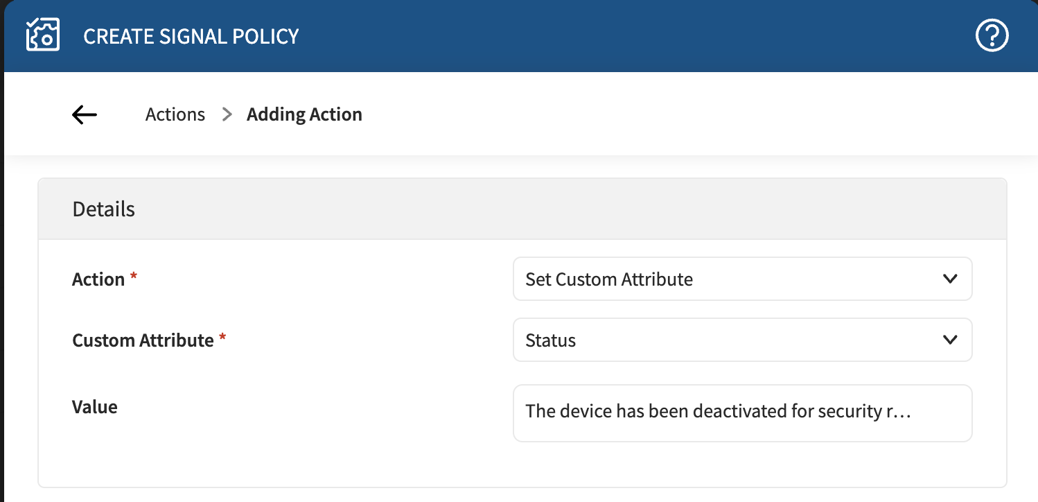

I don't fully understand the scenario but what comes to mind is using a Signal Policy with device side evaluation enabled that changes the value of a Custom Attribute based on an out of contact condition. Then you reference that Custom Attribute as a macro in your Lockdown so that it is displayed to the end user.

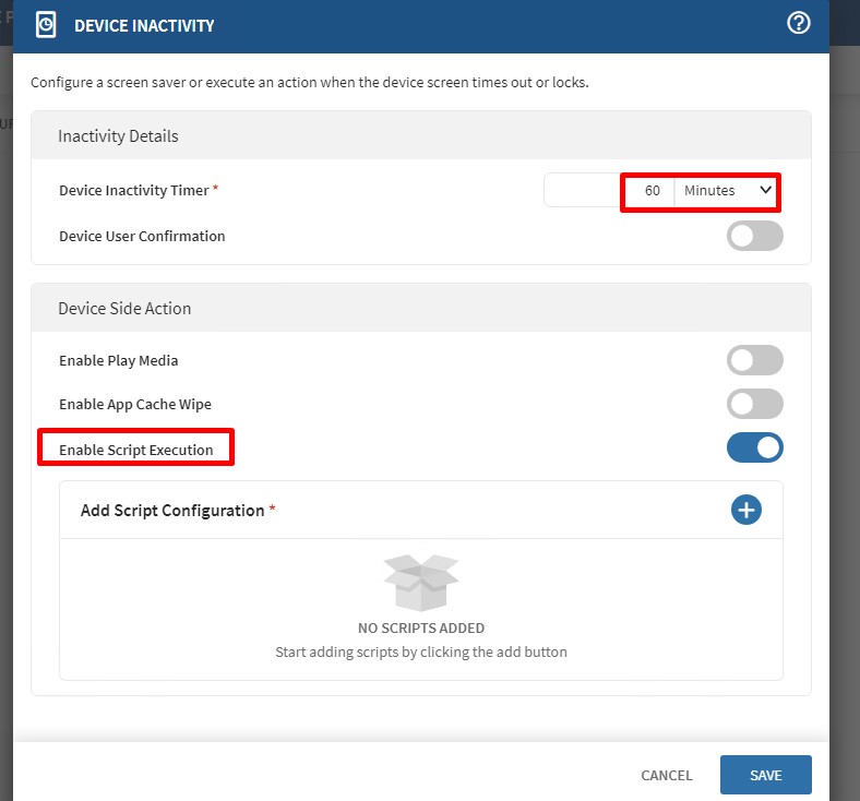

There is a feature called "Device Inactivity" since MobiControl version 2025, you can use it for the use-cases of (device online but not in used by anyone for a limited time), please see the screenshots below, otherwise you may prefer device disconnections if you want to monitor and get action when the device offline more than a specific period.
I hope this helps :)
Zafer
