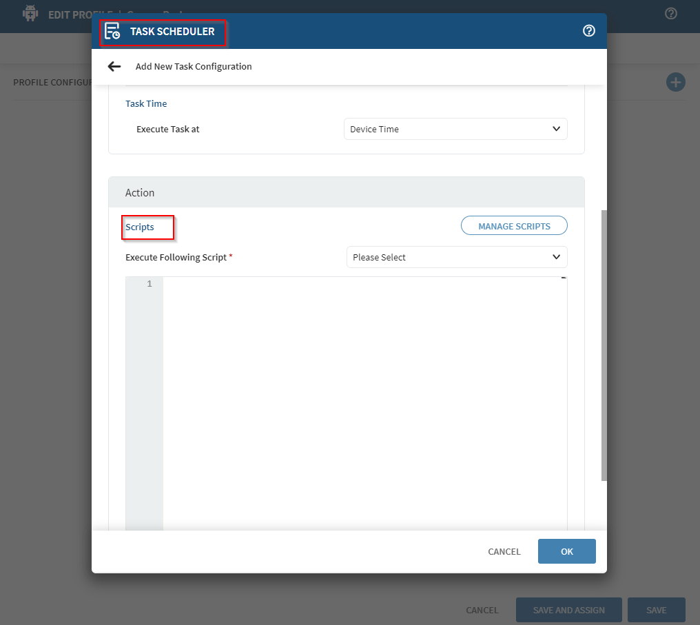

You can use Task Scheduler in the profile as well as the Lockdown profile.
In the lockdown profile you can lock your screen with your company website or either put only one file which can be accessed during the lockdown and after that you can use Task Scheduler Profile to apply lockdown according to your requirements. For example, kiosk on in the script.
Please find attached a screenshot for reference.
