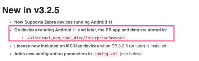

For the applications that I manage I will be moving back out of scoped storage and into shared storage again for configuration files. I will then be requesting the manage_external_storage permission in order to get that access and will use MX to silently grant it. For other applications, they will either need to be redeveloped to do something similar, or they will potentially have to migrate to managed configurations and away from external configuration files. We can see that Zebra Enterprise Browser is moving away from scoped storage and into shared storage to support Android 11:
