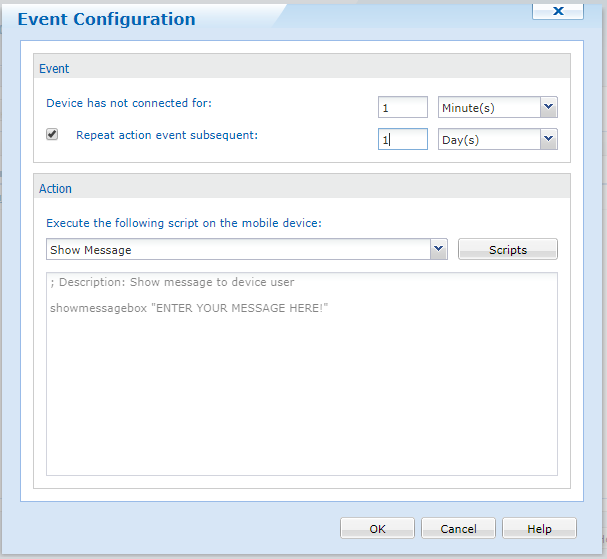

Like your File Sync rule, we can leverage an existing feature to run an offline script.
By using an Out of Contact policy, we can have the device execute scripts after the device goes offline (haven't connected to the Deployment Server after a set period of time).
I have used an example below and this worked for me:
In the example above, once the device have not connected to the server for 1 minute, the script will execute. Then it will execute again a day after (only if the device has not connected back to the server during this time; if the device has connected back, you will have to wait another minute for the script to run and then 1 day again for any subsequent actions).
Unfortunately, there currently isn't a way to schedule a specific time or day for every subsequent action.
Please try the above and see if it can be applicable to your use case.
