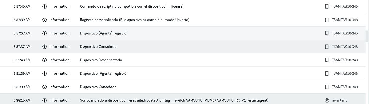

Previously we used version 14.1, which was installed one by one with the agent downloaded directly from the server, then we updated to server 14.2, the tablets updated all their agents by air and in some tablets the samsung rc began to fail in about 12 , so a soti member told me to send the script:
_resetfailedrcdetectionflag
__switch SAMSUNG_MDM57 SAMSUNG_RC_V1
restartagent
And there the situation worsened since of 12 tablets we passed to 120 with this problem, this began in November approximately.
For example on one of the tablets, this is the right moment when the license started to fail after sending the script, on November 14, and from here that sequence of logs is repeated
