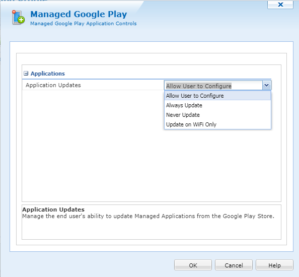

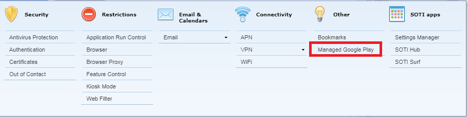

Hello
In version 14.2 there is a new payload for Android Enterprise that allows to configure how these applications are updated:

Hi Laurent,
You are right that if the upgraded app version does not include extra permission(s), the per-app control approach I mentioned in my previous post would not work.  In that case, the only way to block managed Google Play app upgrade is to use the "Managed Google Play" configuration payload in AE profile to globally block upgrade of ALL apps.   In the meantime, we can just wait for Google to introduce more precise per-app upgrade control for its Managed Google Play stores in the future.
