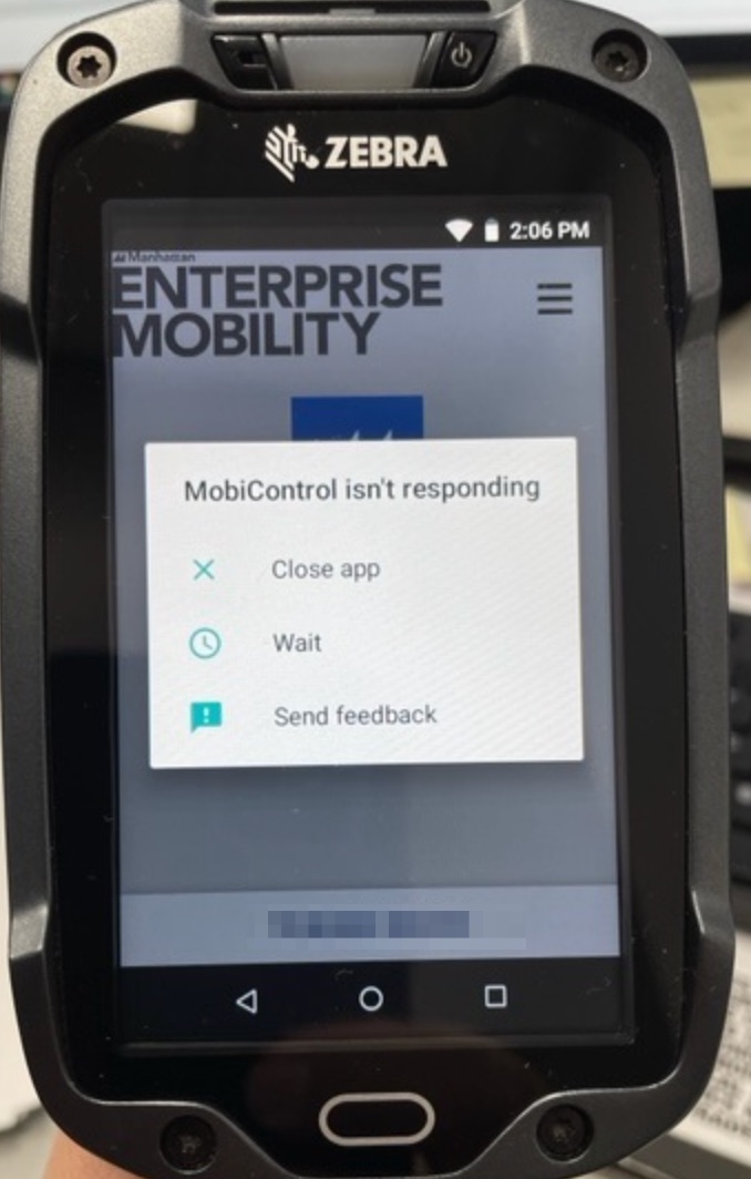

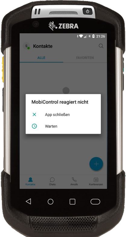

Hi all,
we have updatet all our TC77 to agent 15.1.1 now all 8000 TC77 got an error message that mobicontrol has been stopped... "close or wait" if i choice wait the error message pops up after a couple of minutes. for our employees it's not possible to work with this error message. i have already opend an tickt. but maybe someone of you have an idea and an fast solution . btw. rollback is not possible.
device is zebra TC77 with android 8.1
thx in advance

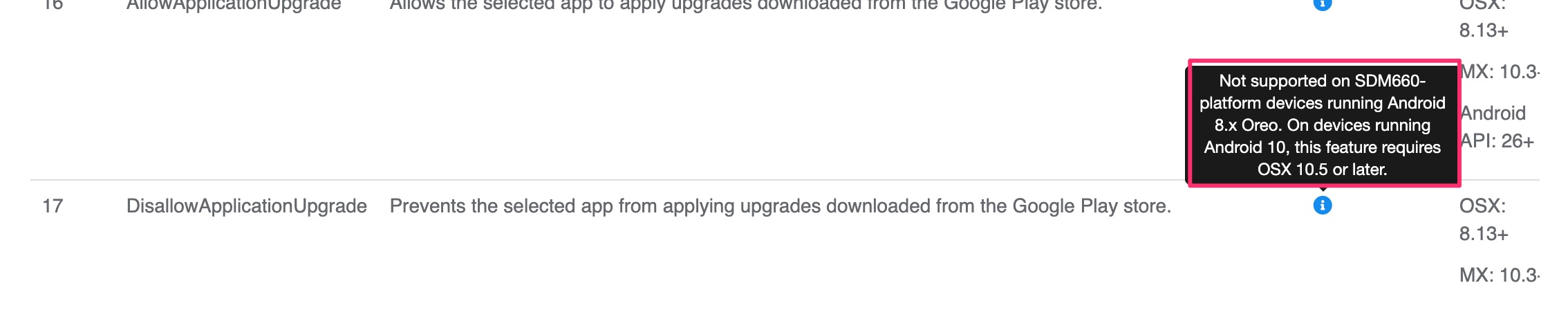

We also use Zebra devices and mitigates this by using Zebras app manager to disallow ("DisallowApplicationUpgrade") upgrades of the Mobicontrol agent. This prevents Google play to update the agent.
https://techdocs.zebra.com/mx/appmgr/
Requires a MX version of at least 10.3.
Works pretty well on our TC26 devices that uses Managed google play. They are still on agent version 15.0.1
4 years ago
Great call. I am going to build a Package for that ASAP to at least stop the bleeding in our environments. Unfortunately it appears that it requires 10.3 AND the devices to be on A10 according to this hover over info link.
This info button conflicts with the OSX 8.13+, indicating that it should work on A8.1 as well, along with MX 10.3 that it shows right to the side.
4 years ago
Following up on this. I tested applying this MX setting on an A8.1 device with MX 10.3 and the MX failed to apply so that does seem to verify the info pop up showing minimum of A10 and MX 10.5 versus the other text on that table of supportability.

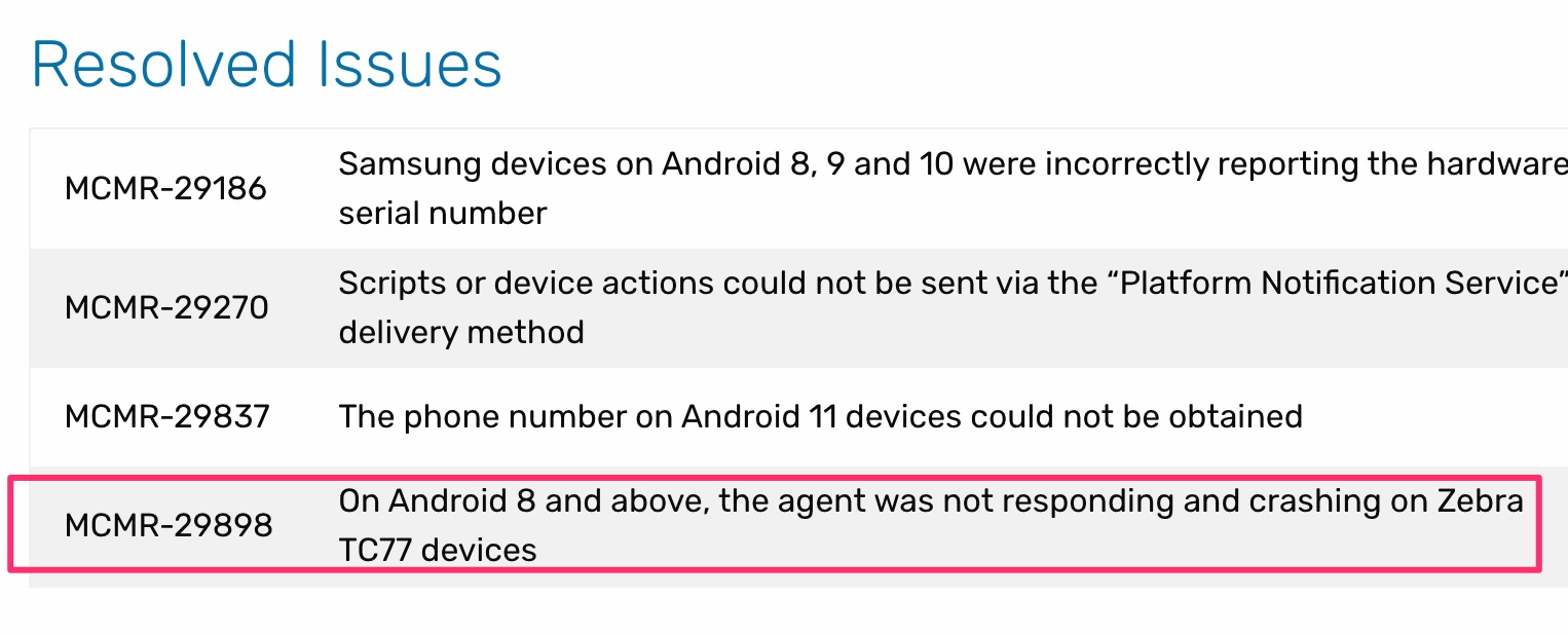

Hello Mark,
Soti Support is aware of this issue and actively tracking impacted customers. We have a few internal cases with developers to find a solution.
The current workaround seems to be as noted in the discussion here to uninstall the zebra plugin.
Though caution is needed for implementing this into production as it may impact some management capabilities.
If anyone else is experiencing this issue I would suggest reaching out to Support@soti.net to raise a case so we may further track and bring awareness of the issue to our internal team.
I'd like to further note about the issue with our agent updating with the profile set to 'never update' as discussed in this thread,
Per our MobiControl release version 15.4.2 this issue should be resolved (MCMR-22799) - https://docs.soti.net/soti-mobicontrol/release-notes/v154/1542/

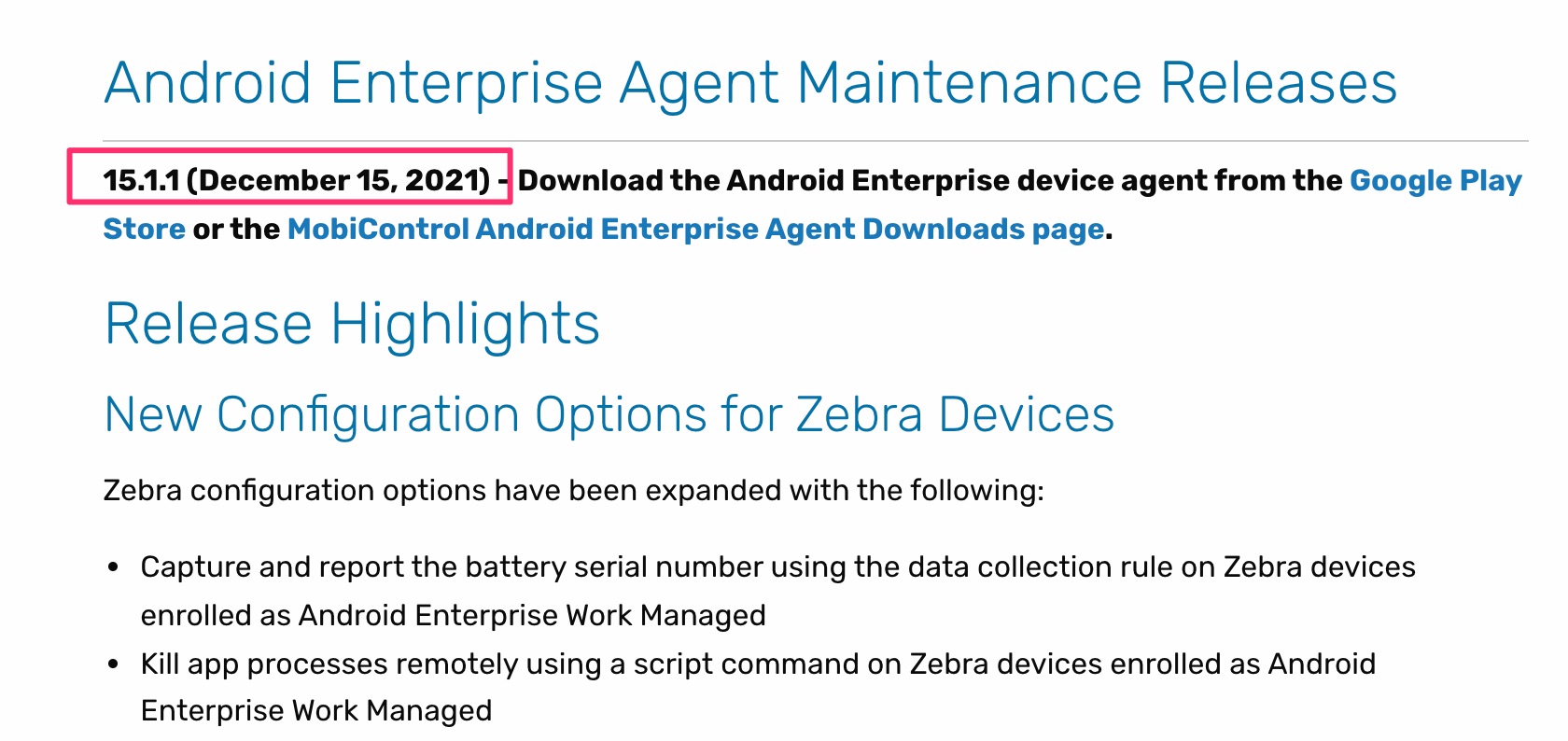

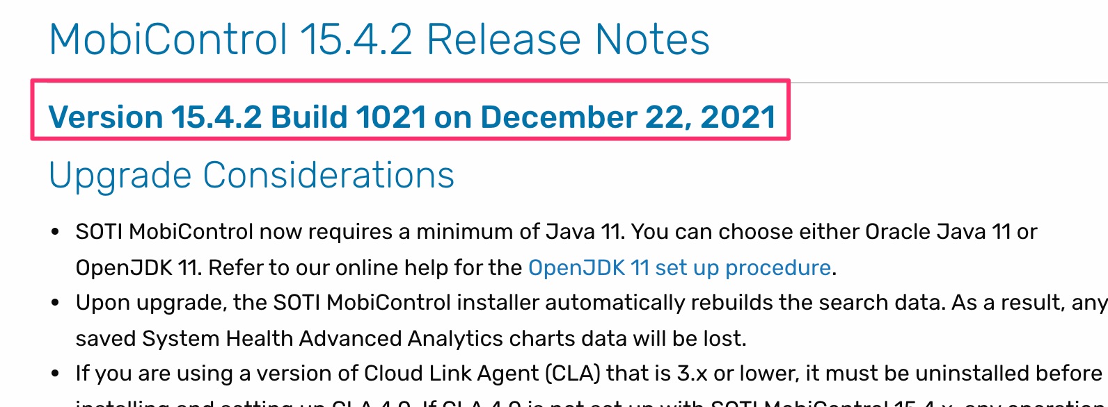

Thank you for confirming what I already suspected to be the case, that the "Never Update" feature of MobiControl didn't previously work. From the timeline it appears the bad version of the agent went public in the Play Store on December 15th, and the fix that provided the ability to disable that auto-update wasn't released until December 22nd. By the time the MobiControl patch was released, 7 days later, it would have already been too late for most end customers, especially given that it would have required a MC upgrade. And here we are almost a full month later and the agent still has yet to be fixed. This is a bad look for SOTI and Android Enterprise management in general.
Bad agent gets released to the Play Store on December 15th:
Ability to prevent the auto-update to the bad agent was not released until December 22nd, and requires an MC upgrade:
