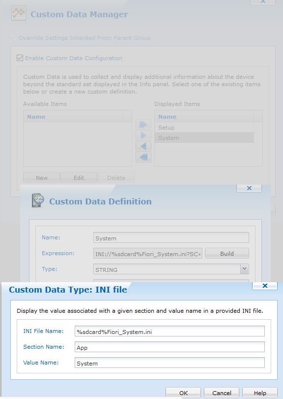

My Answer :  Yes only if the value shown is exactly what you set in your ini file on the device.

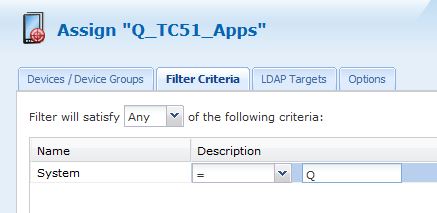

Can you attach a screenshot of what you set in your custom data expression field?

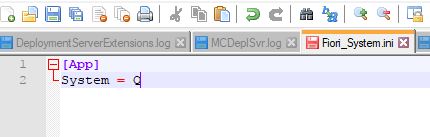

Yes, the value shown is exactly what I set in the ini file
I've attached screenshots from the actual .ini file, profile filter criteria settings and the custom data definition itself.
