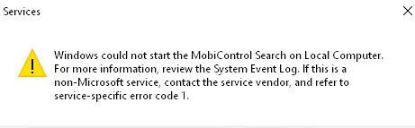

Thank you but everytime when I would like to run the service I get this:
A
ANKMOD@SOTI
Hello Jan
Greetings
Thanks for your Post To Soti Central!!
As per screenshot , it seems that your search service is not working after rebuilding indexes as per my above mentiond post and i can see , you also have an opened case also and meeting is going to be schedueled soon and  i will also check with agent after that meeting.
In the mean time  Can you confirm if you have verified from your Mobicontrol admin utility to see if the search certificate is not expired.
Kindly try to restart the search two three times and note down the time stamps and see any exception or error in logs section from C:\Program Files\SOTI\MobiControl\Search\logs (check the latest Mobi control search log file) and share that
Kindly restart search service and check  exception by putting mobi control search logs in verbose from MC admin utility section.
As there is a recent upgrade happend so might be a chance your MC_Java_Home path is not pointing to the actual java installation location so you can verify that by going into Control Panel\System and Security\System\ then click on advance system settings section and check environment variable there you see a similar section as mentioned below so verify the MC_Java_Home path as it should be pointed to the same location as where java is installed eg to C:/ProgramFiles\java\jre1.8.0_191
If path is not same , then you can try to either reinstall java version or change the path to actual one and try to restart the search service again . (Before doing any changes on system end , you should take snapshot of the server so that you can always points back if there is a need)
In case of any other question , Kindly let us know.
