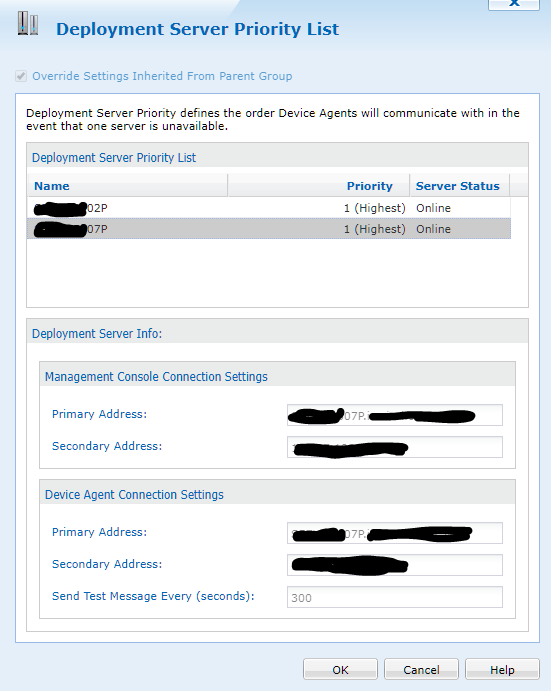

Both DS are set at priority 1 but it's "07P" that have the high spikes in queue length (see image).

It's the same DS priority for the whole system.

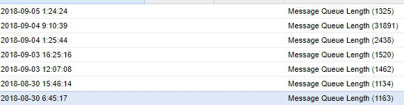

Unfortunately we haven't had the alert rule running for more than a week. Another observation is that even when the queue length is low or zero, the system seams slow. For example if we request a device check in, some times it takes several minutes before the device acctually checks in. This is just one example of many things that seems to be effected by our perceived lack of performance in mobicontrol.
The long delay to get device check-in and your attached timestamps have already given me some more tell-tale signs on potential problems.  Based on all your screenshots and descriptions so far in all the previous posts, I believe some configurations of your HA servers and settings of your policies were improper, or at least non-optimal, for HA implementations even before your server upgrade.

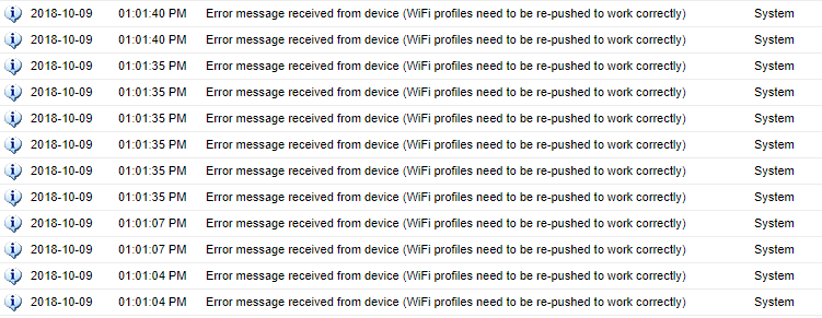

We had the same issue performing the same upgrade. In our case, when agents started to upgrade, devices started to report an error about a Wi-Fi profile.
We just had to gradually push a new Wi-Fi dummy profile so that new agents stop repporting the Wi-Fi profile error.
It seems that new agents use a different key to encrypt and decrypt Wi-Fi passwords and once you push the dummy profile all profiles are regenerated.
I hope this helps.

The queue length was progressively reduced in a couple of days from 50k to 0 by just pushing that dummy wifi profile.
We still have this profile active so that devices that have not been online for too long can regenerate wifi profiles with the new encription key.
