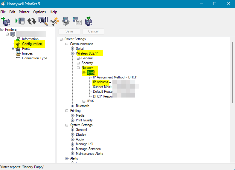

2. Check the Printer's IP Address
in PrintSet, navigate to: Printer → Config → Wireless → Network → IPv4Honeywell PrintSet Configuration
  • Note the printer's IP address.
  • If the printer does not have an IP address, configure the wireless settings. Refer to the Honeywell PrintSet documentation for instructions on setting up wireless connections.

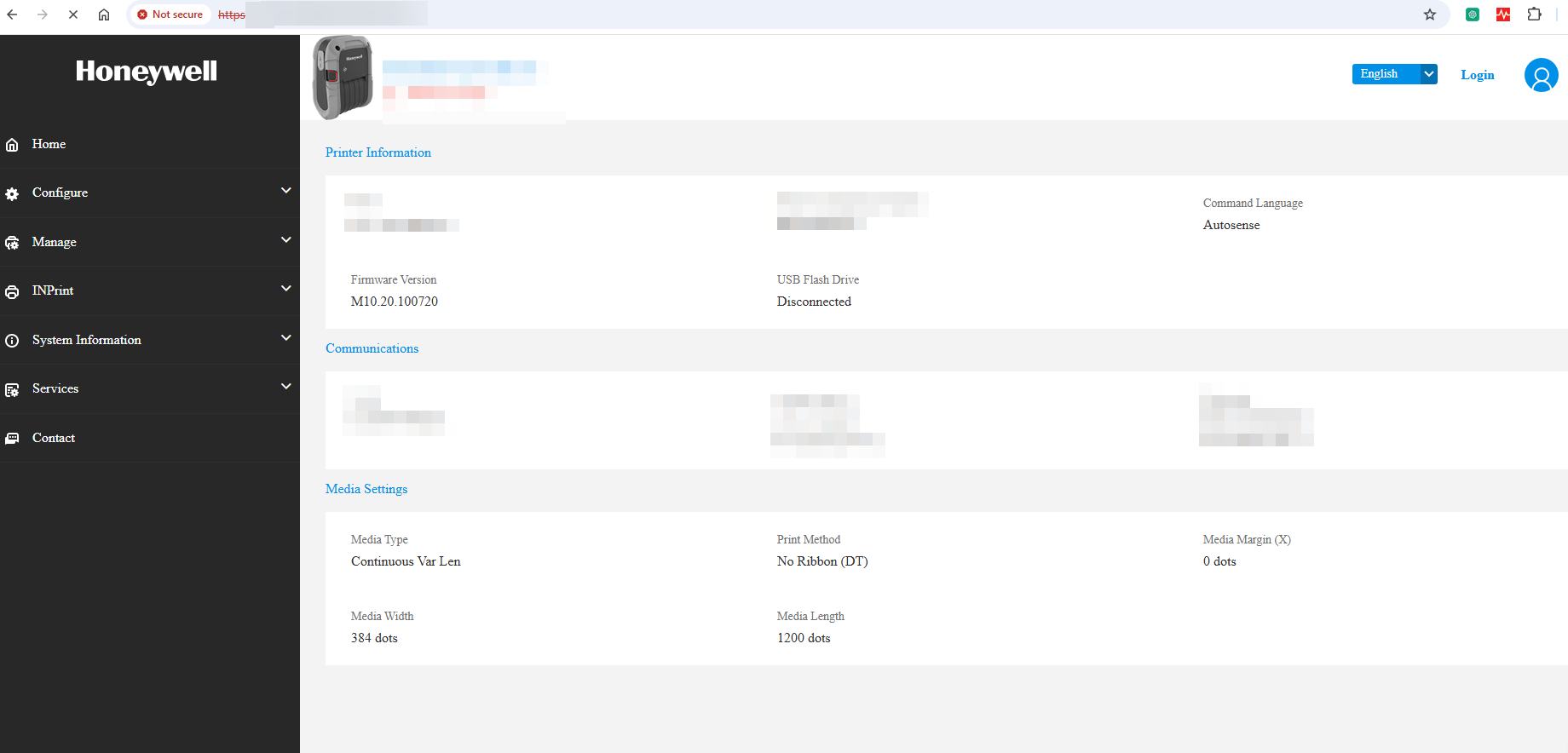

3. Access the Printer's Web GUI
Open a browser and navigate to: https://<Printer_IP>
Default credentials:
Username: itadmin
Password: pass
Note: If the default credentials do not work, please contact Honeywell or your reseller for the correct login details.

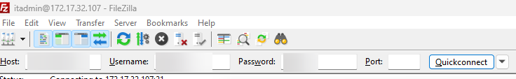

7. Connect to the Printer Using FileZilla
Launch FileZilla and enter the following connection details:
Host: <Printer_IP>
Username: itadmin
Password: pass
FileZilla

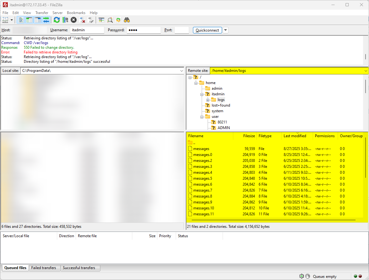

8. Download the Logs
  • Once connected, navigate to the following directory: /home/itadmin/logs
  • Download the file named messages, which contains the printer’s log file.
Logs
Note:
  • Credentials may vary. If the default credentials do not work, please confirm with Honeywell or your printer provider.
  • Ensure FTP is enabled on the printer before attempting to connect with FileZilla.
  • Always store logs securely before sharing them with support teams.
