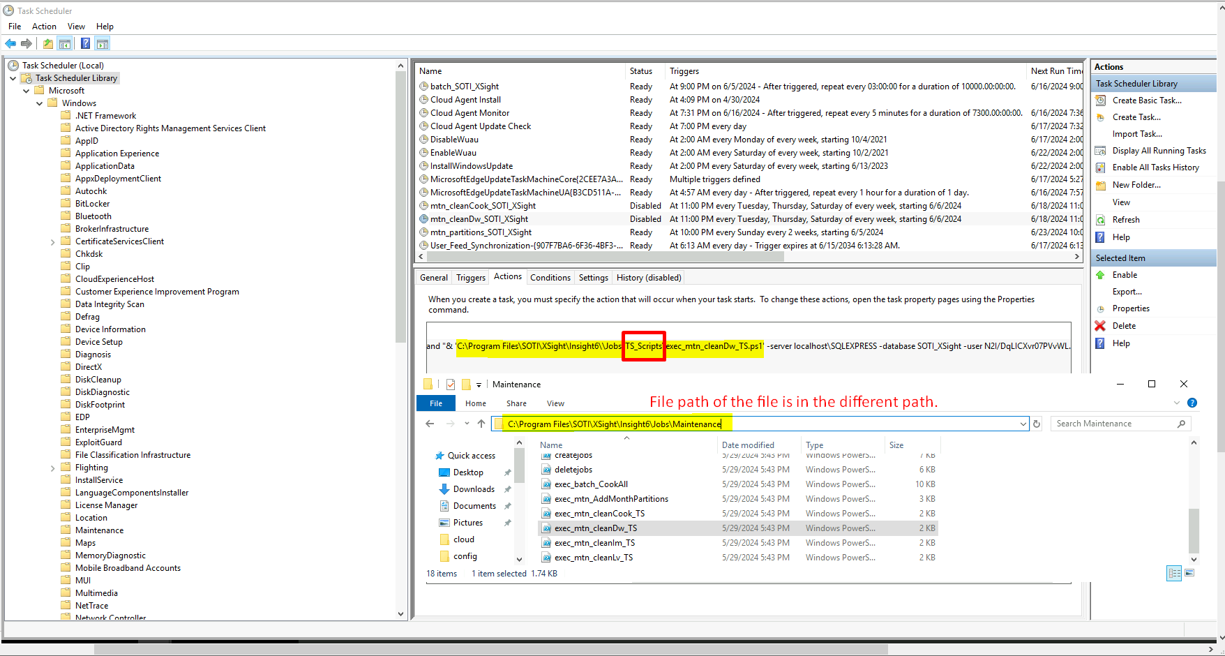

  • Ensure that the scheduled SQL script for database maintenance is correctly configured in Task Scheduler and executes at the designated times.
  • Regularly verify that the script file is located in the correct path and is accessible by the system.
Cause
The SOTI XSight Cook database can exceed the 10GB limit imposed by SQL Express, potentially impacting performance or functionality. This typically occurs due to the following reasons:
  • A scheduled script in Task Scheduler failed to execute at its designated time.
  • The script file has been removed or is missing from the path specified in Task Scheduler.

The Cook DB Cleanup script for SOTI XSight is located at: C:\Program Files\SOTI\XSight\Insight6\Jobs
Task Scheduler is shown with the maintenance script listed, scheduled to run but not executed as intended.
