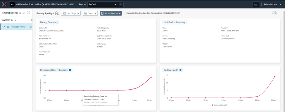

The latest SOTI XSight patch introduces an improved feature for Power Precision batteries that calculates the moving average for the remaining battery capacity where negative values are currently being displayed.
SOTI XSight
Issue Description
Previous versions of the SOTI XSight 2024.0.1.3 XT Socket for Zebra smart batteries for Power Precision provide values that impact the smart battery dashboard and the battery spotlight. The Remaining Battery Capacity will consistently appear in a negative format when calculating its moving average. This is due to the current capacity values being unavailable, how it reports data to the XT Socket, and how it is displayed to the dashboard.
