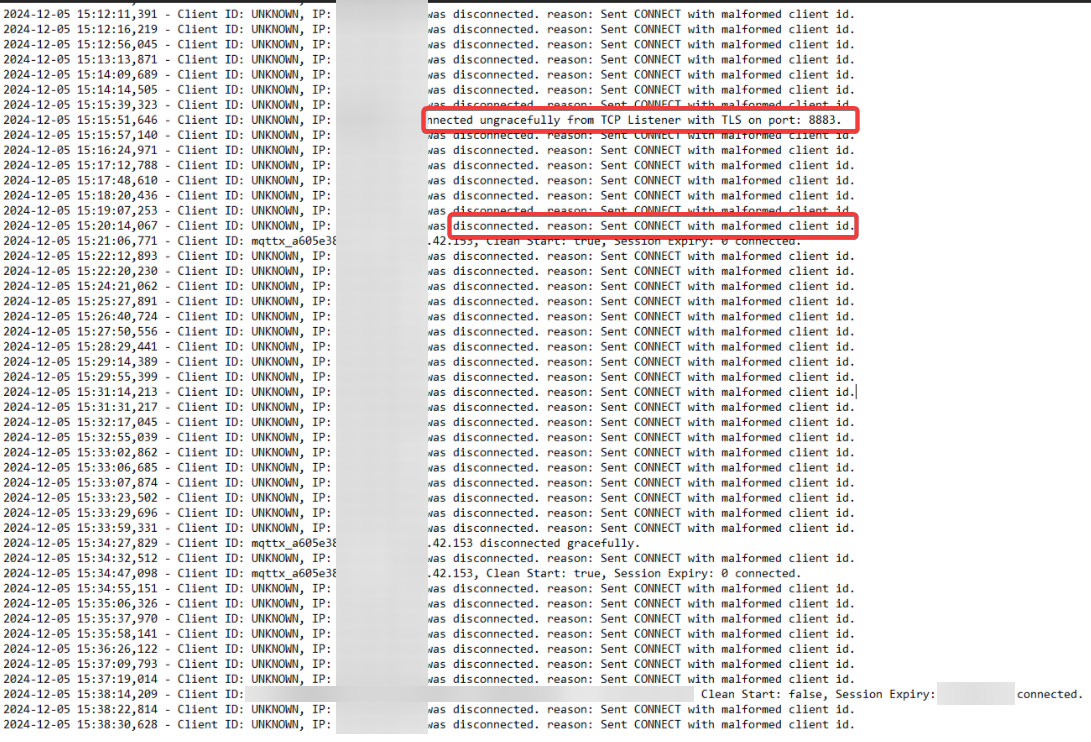

The following error can be seen in the broker logs:
A log screenshot showing multiple entries of client connections and disconnections. Many lines indicate the disconnection reason as "Sent CONNECT with malformed client id."
Event logs from HiveMQ:
2024-12-09 21:00:17,412 - Client ID: UNKNOWN, IP: 136.********* was disconnected. reason: No CONNECT sent in time.
2024-12-09 21:00:20,713 - Client ID: UNKNOWN, IP: 170.********* was disconnected. reason: TLS handshake not finished in time.
2024-12-09 21:00:23,321 - Client ID: UNKNOWN, IP: UNKNOWN disconnected ungracefully.
2024-12-09 21:00:28,533 - Client ID: UNKNOWN, IP: 142.********* was disconnected. reason: Sent CONNECT with malformed client id.

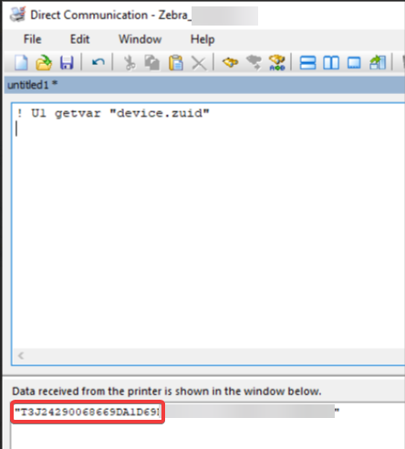

      • The ZUID of a device that works as expected is an alphanumeric value.

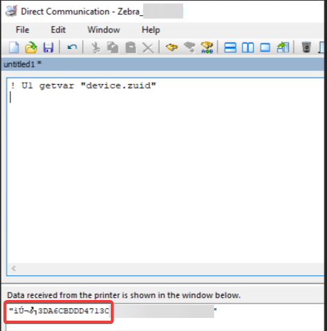

        A screenshot of a Zebra printer communication tool displaying the same command ! U1 getvar "device.zuid" executed, but with a response showing a different ZUID: T3JZ42900E6E9DA1D691
      • The ZUID of a ZT510 device that is having issues has special characters.
        A screenshot of a Zebra printer communication tool displaying a command ! U1 getvar "device.zuid" executed, with a response showing the device ZUID as *ïð~3DA6CBDDD4713C
