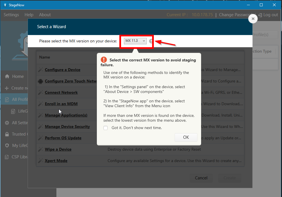

  • Find the MX version of the device that you want to wipe. On the device, go to Settings > About Phone > SW Components > MX.
Note: The minimum required MX version is 4.2 or later, but SOTI recommends that you use the latest available version. You can upgrade the MX version through an OS upgrade.

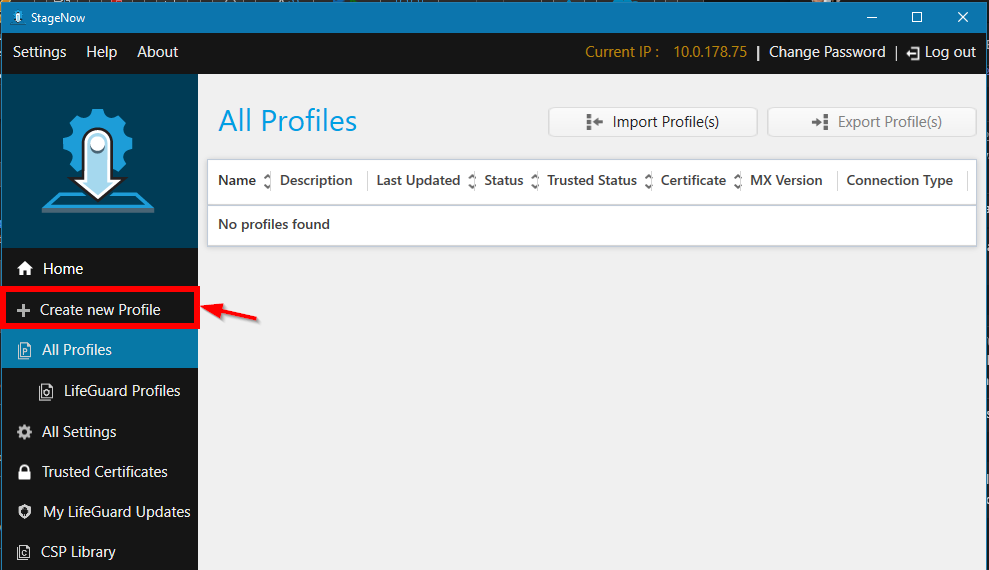

2. In the StageNow tool, select Create New Profile. The profile creation wizard opens.
3. Choose an MX firmware version that matches your device, and then select OK.

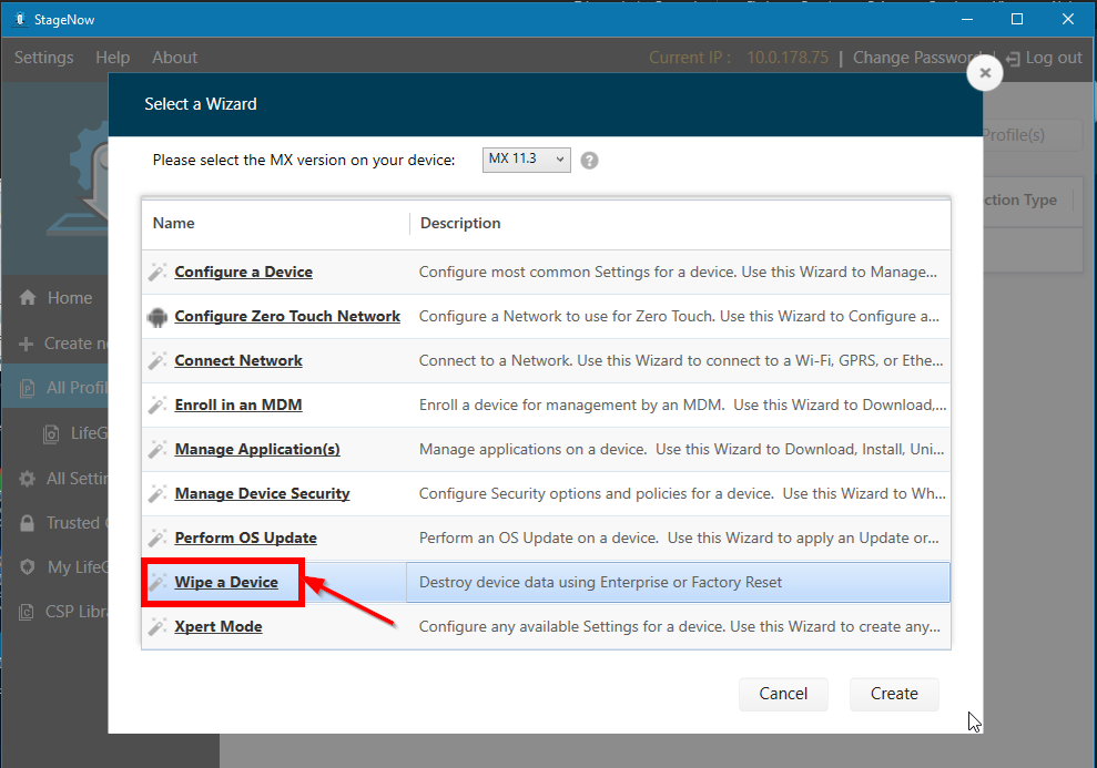

4. Select Wipe a Device.

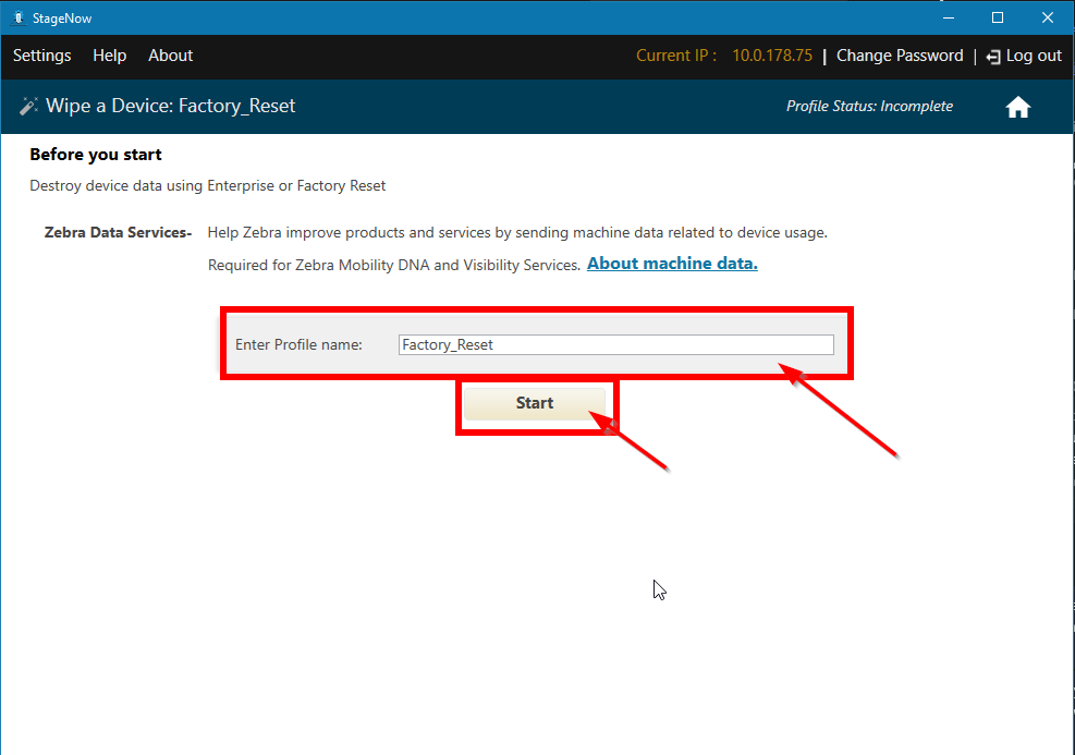

5. Enter a name and a description for your wipe profile, and then select Start. Don’t use special characters.

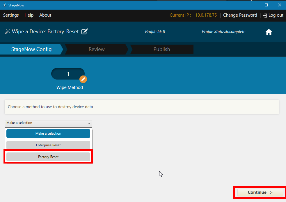

6. Select Factory Reset or Enterprise Reset as required, and then select Continue.

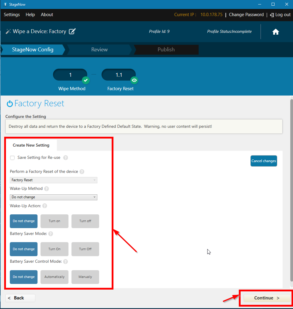

7. Choose to keep the current configuration or modify it to suit your needs, then select Continue.

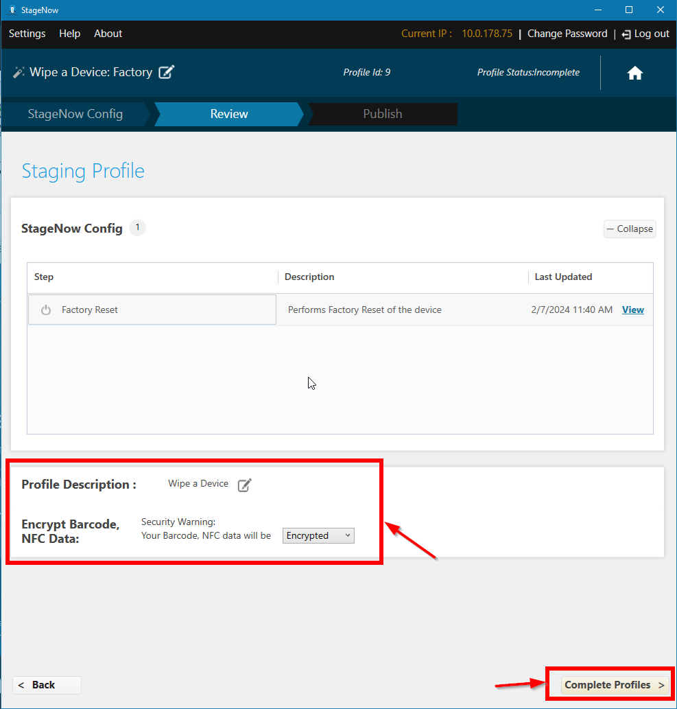

8. Leave the encryption settings unchanged or switch to Unencrypted if required, then select Complete Profiles.

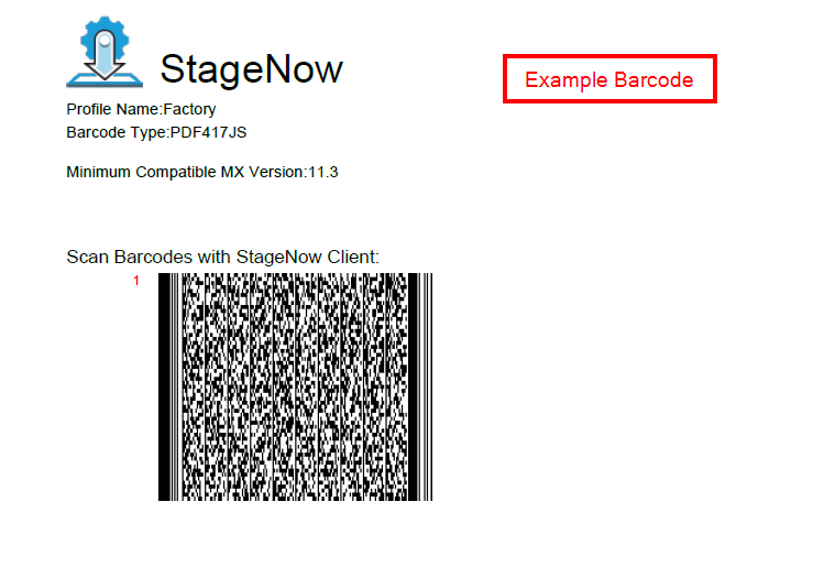

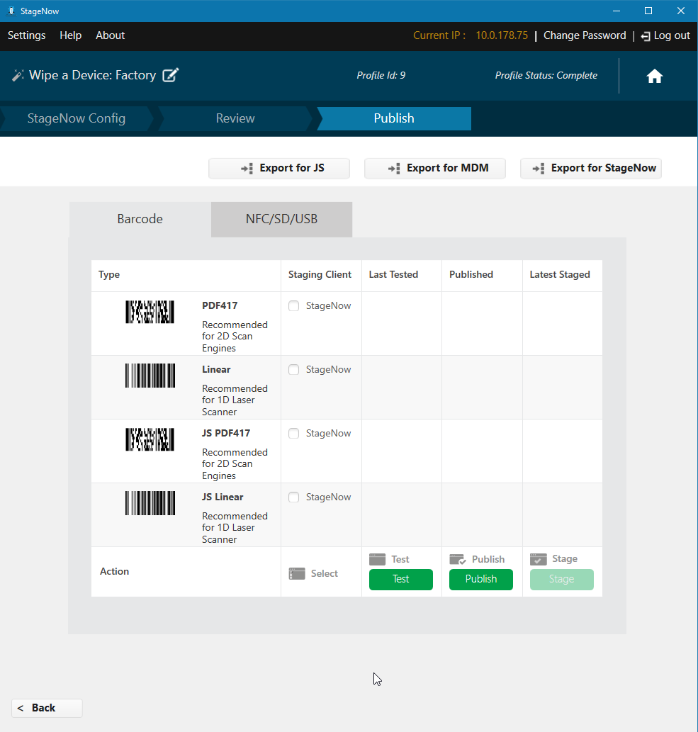

9.  In the Publish section, choose the appropriate scanner type (2D/1D) and select Test to be prompted with the staging barcodes.
Note: Barcodes can be published once the Factory Reset or Enterprise Reset is tested and confirmed.
An example barcode
10. Print the barcodes or display them on another device.
