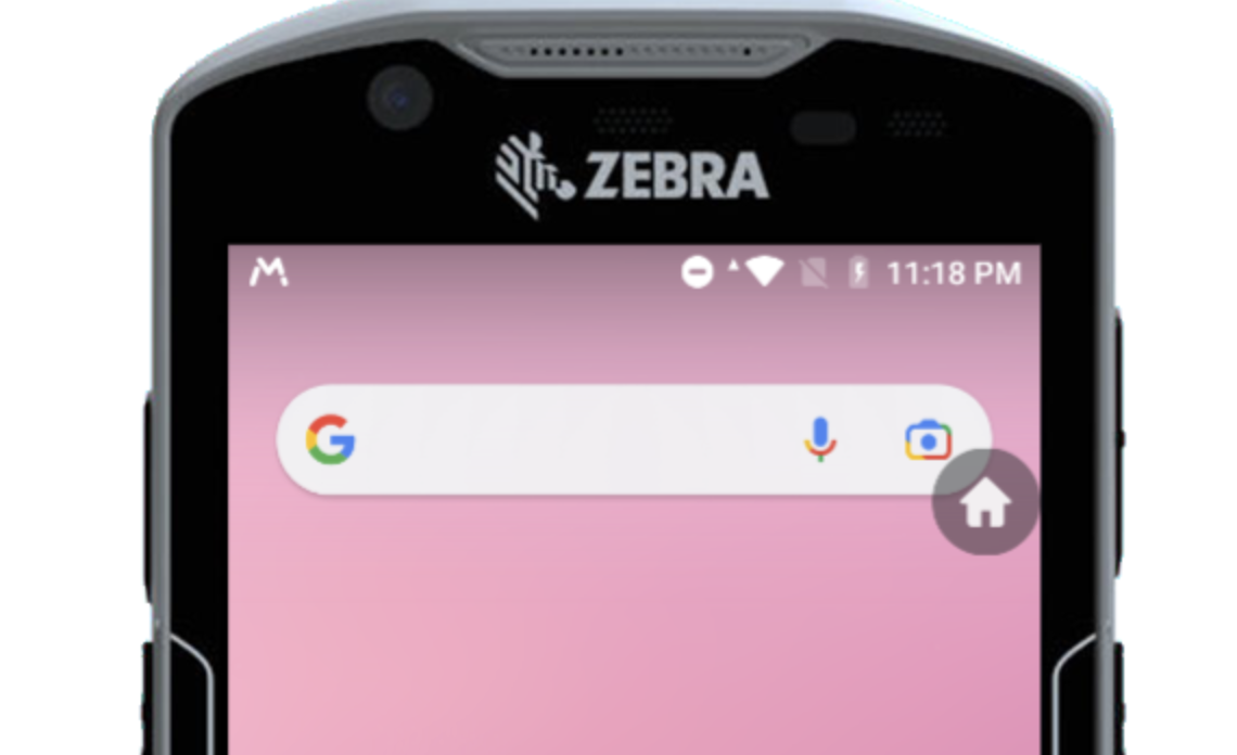

The devices are not running the SOTI XSight agent. This is evident by the X icon missing on the status bar:

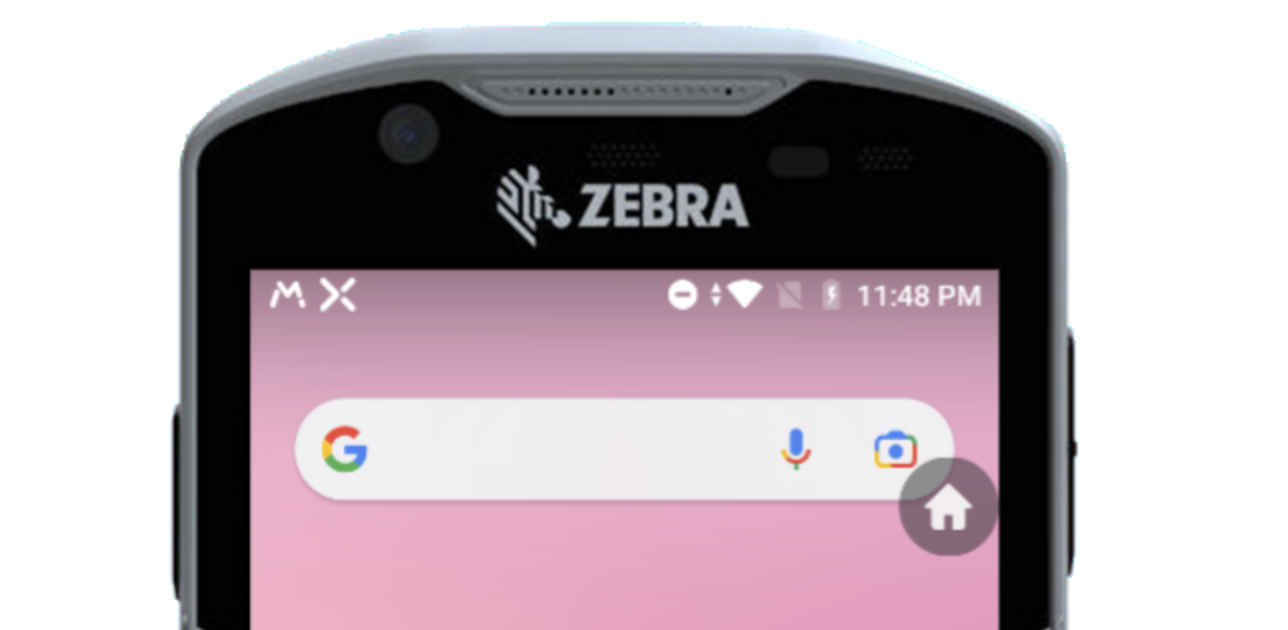

3. The last option is to manually open the SOTI XSight agent. The icon displays in the status bar once the agent is running:
