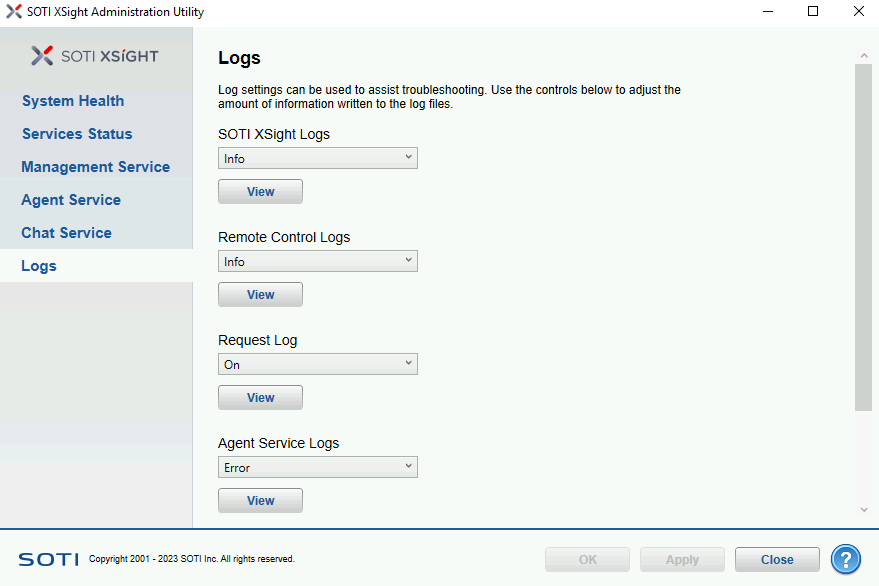

The SOTI XSight server log files are in the SOTI XSight Administration Utility. Additionally, we can change the log settings to Verbose prior to reproducing the issue for further information regarding debug logs.
Note: Switch the logging back to 'Error' or 'Info' post log collection.

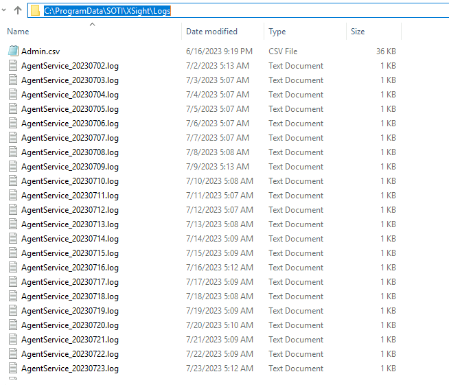

As an alternative, direct access to the logs can be found in the following file path: C:\ProgramData\SOTI\XSight\Logs.

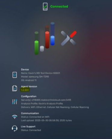

On the XSight agent, press and hold on the agent version three times in succession to bring up the event log menu.

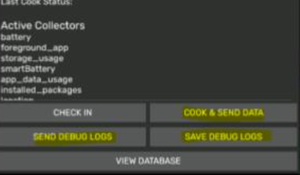

Note: The main log and device info menu will appear on the screen, allowing you to save the logs locally on the device or send the logs over to SOTI's FTP server.
Alternatively, the following intent action can be used to automate the device to send the debug report to SOTI's FTP server.
sendintent -b "intent://net.soti.xsight#Intent;action=send_debug_report;component=net.soti.xsight/.receivers.ServiceCommandReceiver;end"
