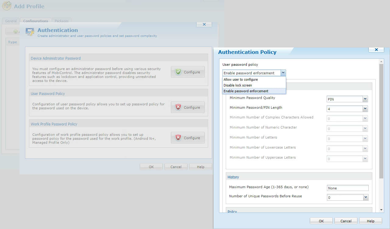

- Setting the authentication profile?
RM
Ravikant Mishra
Authentication profile as per screenshot.
Make sure you not using very simple password like 0000, 1111 or 1234 etc. and are you using action items to reset passcode or script Resetpassword xxxx ??
