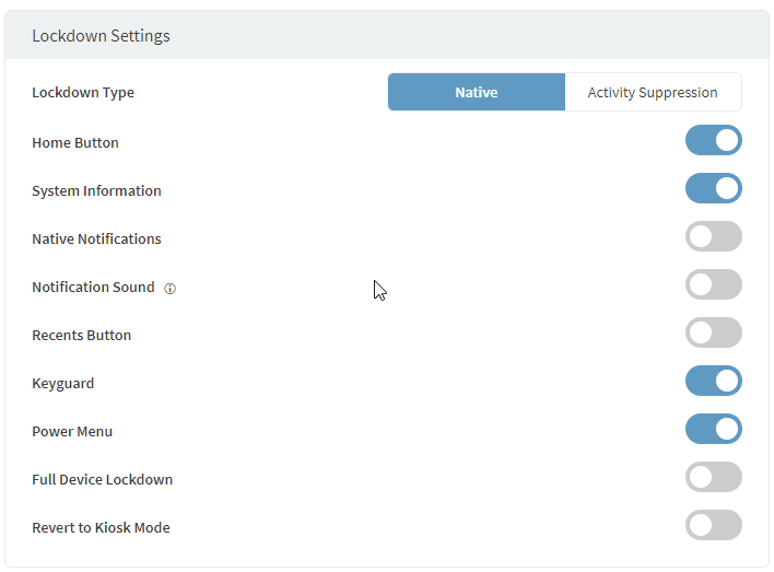

Since we started using SOTI MobiControl for our Honeywell EDA52 Devices, we have the problem that after the device has not been used for a while (about 1 hour) the scanner of the device does not work anymore. That is, when pressing the scanner button simply nothing happens.
The only solution to fix this problem is to restart the device.
If the device is used continuously, the problem does not exist. Only after a break does it happen that the scanner no longer works.
Our devices run in lockdown mode with these settings:
Using the lockdown type "Activity Suppression" is not an option, because there are simply too many functions enabled that should not be enabled.

Hello Tim,
I was wondering if you finally found the solution for this issue.
If not, can you test enabling the Recents Button in the lockdown configuration?
I've found that for some apps (like google phone), in some devices, this option must be enabled to work properly.
