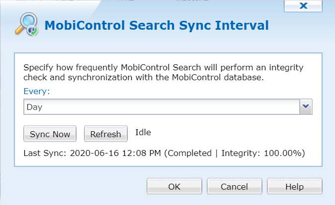

Navigate to MobiControl Search Sync Interval under Global Settings and confirm the Integrity is at 100%. In case if it is lower than 100%, sync and refresh it until it shows 100% as shown below. Then you will see all the devices back on console.
If the issue still persists, please share the picture of Search sync integrity.

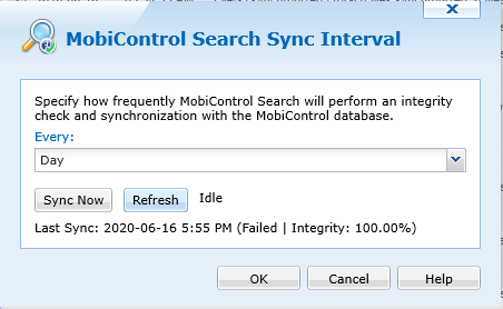

Hi
It's showing as Failed | Integrity 100% as per below
