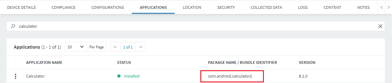

Hey Raymond,  This is a little bit older thread but I have a question here.  I have two TC52 devices both with Android 11 installed. Both were upgraded from either Android 9 or 8.1 to 11.  One has been wiped and re-enrolled after the upgrade.  The other has just been in SOTI.  The ones that get wiped re-enrolled show the bundleID as com.google.android.calculator.  But the one that is just upgraded without a wipe shows as com.android.calculator2.  is there a way to have a single lockscreen item that points to both bundle-ids?  I tried as you suggested here and the newly enrolled works but the one that still has com.android.calculator2 does not.  I don't want to have two different lock screens.  My other option is to try to uninstall and then re-install to see what we get.

I have the exact same problem, Also tried uninstalling com.android.calculator2 via adb and installing com.google.android.calculator manually via apk but somehow it changes automatically back to com.android.calculator2

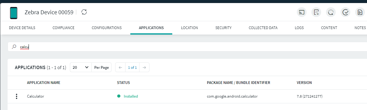

Hi Rohit,
Thank you for posting on SOTI Central and thanks Raymond for responding to the post.
Would you please confirm if it is the correct Bundle ID in your MobiControl Web Console?
1. Navigate the device details and click on "Applications" tab.
2. Type Calculator and confirm.
Please let me know if this helps.
Kind regards,
RS
Rohit Sharma
4 years ago
