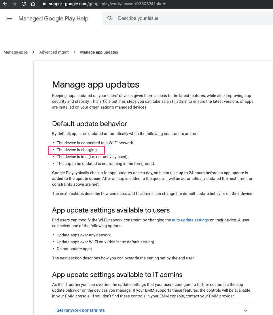

I believe that Google play updates will only occur automatically on devices on AC power. On my Pixel, Samsung and Zebra devices any apps that are set to Mandatory start to update automatically once the device is plugged in.

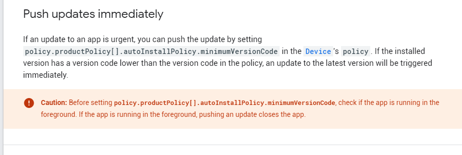

We've recently brought up the issues with the update criteria to our account team. We also found this:
https://developers.google.com/android/work/play/emm-api/update
When we asked if SOTI utilizes this policy configuration to update apps immediately, we were told they do not yet, but it is in the roadmap.

Do you think there will be any changes to this in the future. We have quite a lot of devices which are used almost all the time and also most of the time they will leave the device with the app running, hopefully charging the device thou.
It would be good to be able to force the update anyways. Of course we could do like a kill_application first but that won't solve the possible charging problem.
It's going to have to change for the enterprise use case. We have many environments where the devices will never be in a charging state because they use replaceable batteries with battery chargers instead of device chargers.
