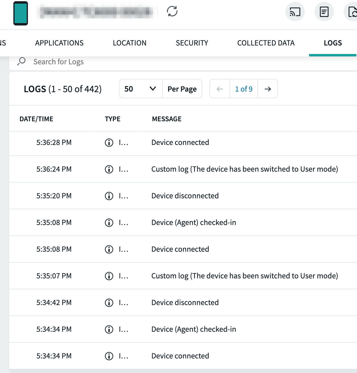

I have been driving myself crazy trying to find the root cause of this. The MobiControl agent on our TC8000 scanners are constantly disconnecting and reconnecting. The worst part of it is that eventually it will cause the scanners to completely lock up and they have to be force rebooted. The workaround right now is to disable the MobiControl agent on the scanners (force close the app) which will prevent them from locking up, but obviously the downside is that I can't remotely manage them while the agent isn't running.
I have tried disabling Doze mode, disabling Bluetooth, GPS, etc. and nothing seems to work. I even went as far as reinstalling SOTI and completely rebuilding the SOTI database as I thought maybe the database got corrupted somehow, but it didn't change anything.
Our wireless network in the building is rock solid so I know that is not what is causing the agent to crash.
Does anyone have any other ideas that I can try?

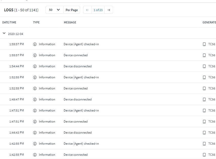

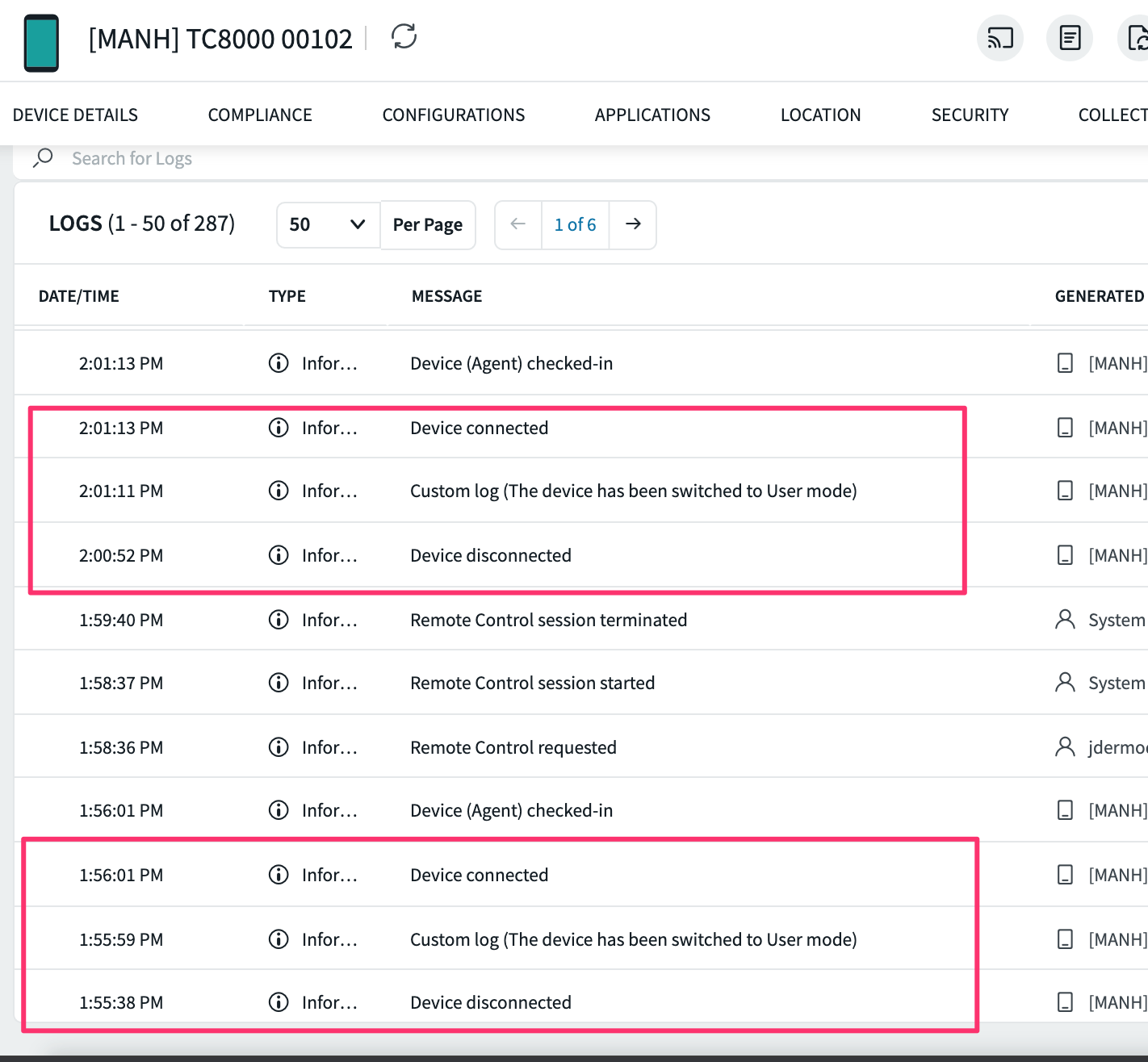

As you can see from the logs of this particular scanner it was constantly disconnecting (all day) until finally at 4:46 PM the scanner froze and I had to force a reboot. This happens a lot on scanners that are connected to SOTI.

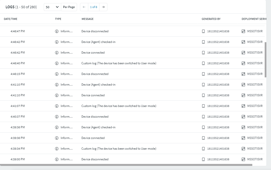

I've noticed this issue happen even when a scanner is stationary. There is something happening on the scanners that is causing the agent to crash and reload (at least that's what I believe is happening).
The signature in the log where the device switches to User mode in the middle of the disconnect and reconnect seems especially unusual. Are you using The SOTI Lockdown in conjunction with another lockdown like EHS?

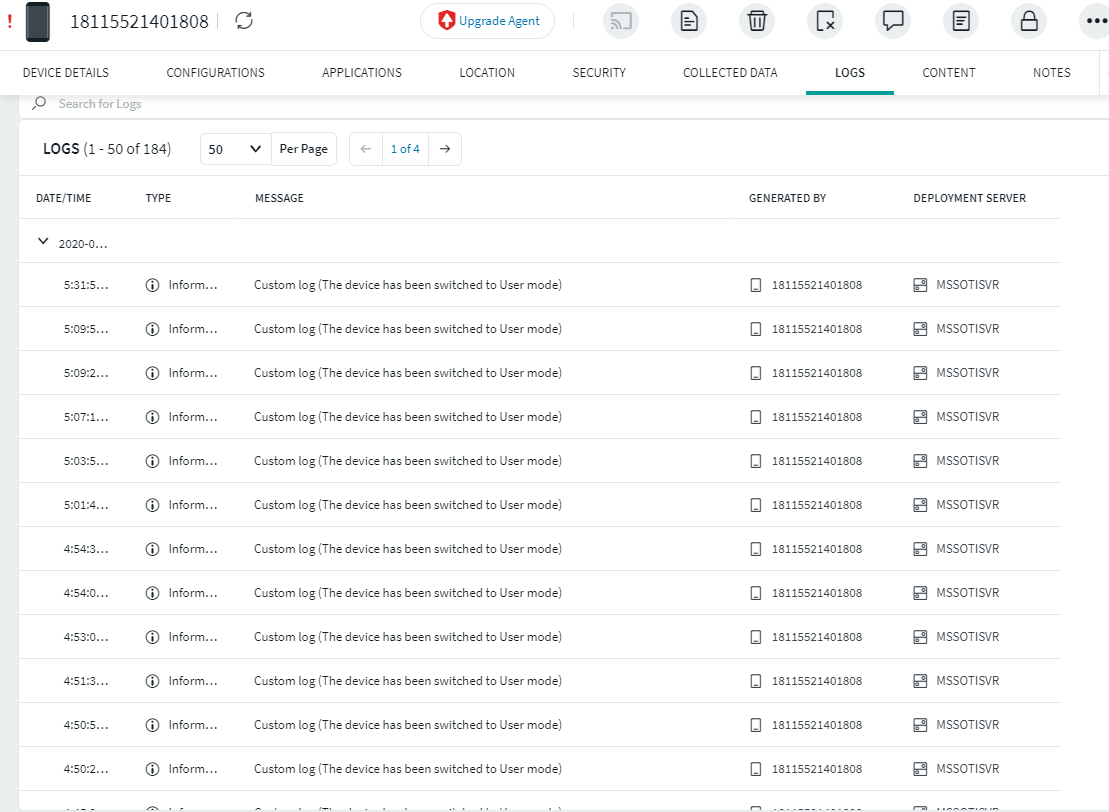

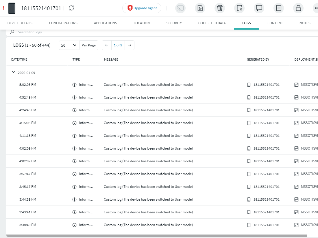

Here is another scanner that I actually have disabled in SOTI, but it still populates the log with the User mode entry.
ND
Nathan Davis
And another...

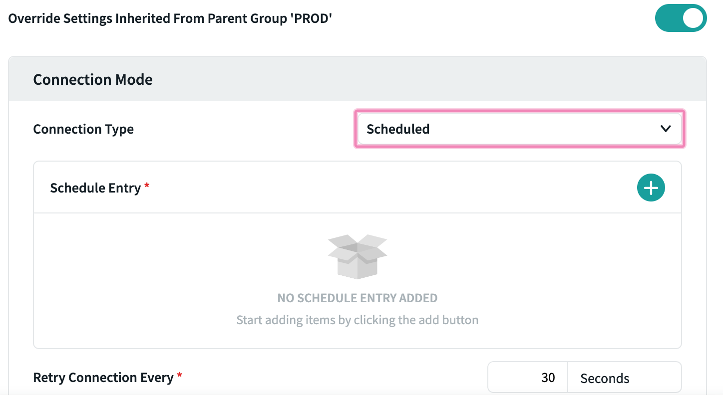

I'm about to experiment with changing the connection setting from persistent to scheduled, is that what you did Nathan, or did you set it to Manual, or something else entirely?

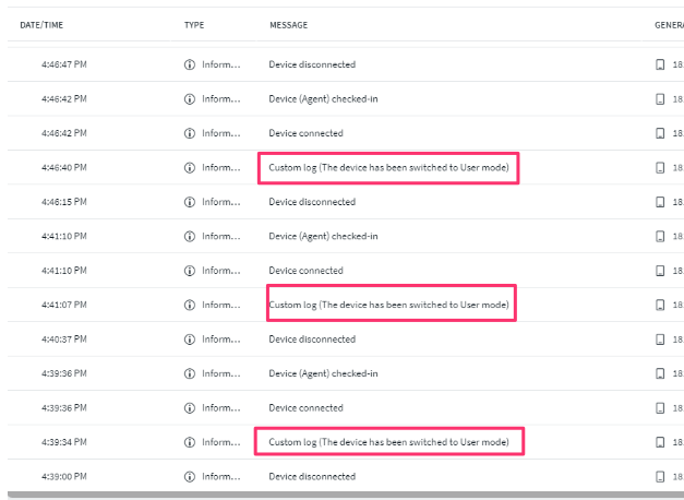

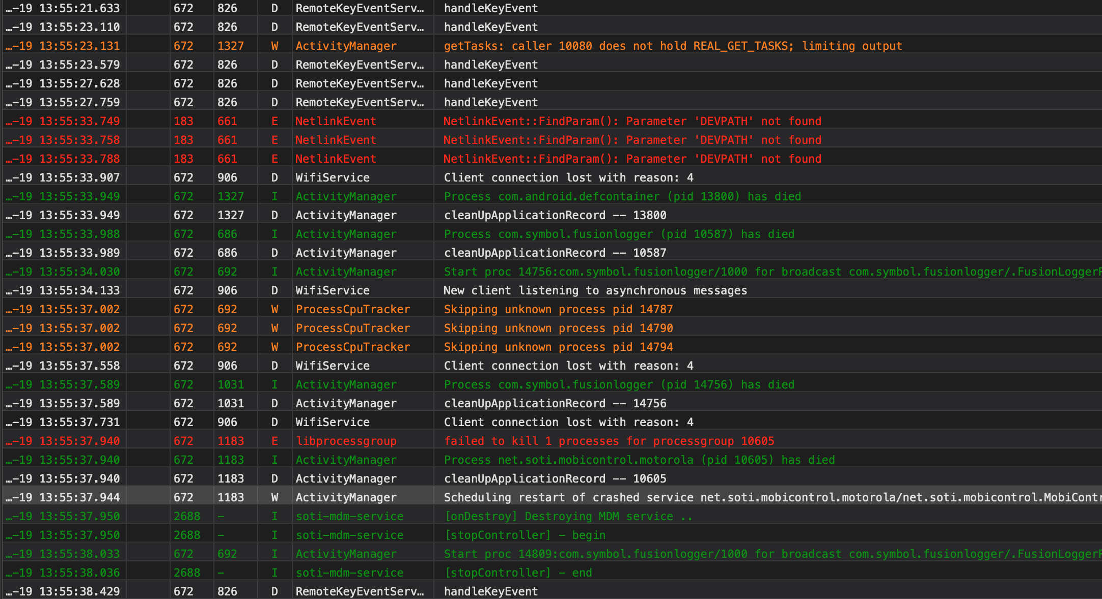

I made some headway on this today but am still struggling with RCA.

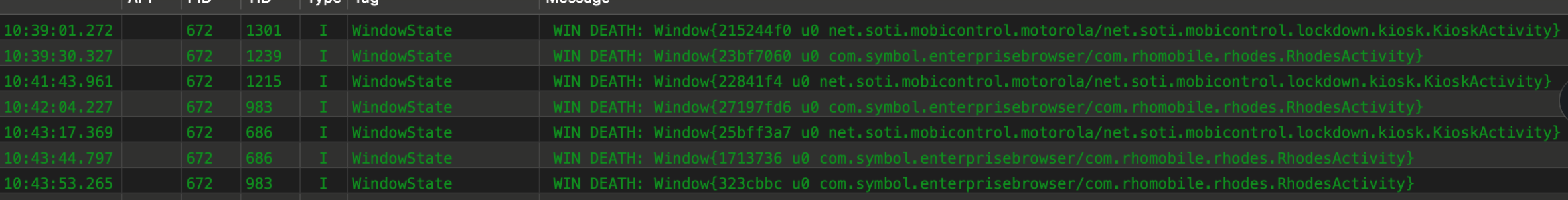

I found that whatever application the end users were using (Zebra Enterprise Browser in this case) would crash at it seemingly vied for foreground control with the lockdown/kiosk.
I couldn't have the LoB app crashing in the middle of use so I opted to remove the lockdown from the picture so that end users could at least work without interruptions. This was fairly successful in that the App crashes stopped, but this also left the devices wide open without a lockdown, not ideal. I may end up putting EHS on the devices as an alternative if I can't figure this out over the next couple of days.
After the lockdown was gone I noticed that the disconnects and the entering user mode issues were still showing in the server logs. I've been pouring through the various device level logs ever since and have found a strong correlation to the SOTI service crashing on the device at the point that the disconnect shows in the server.

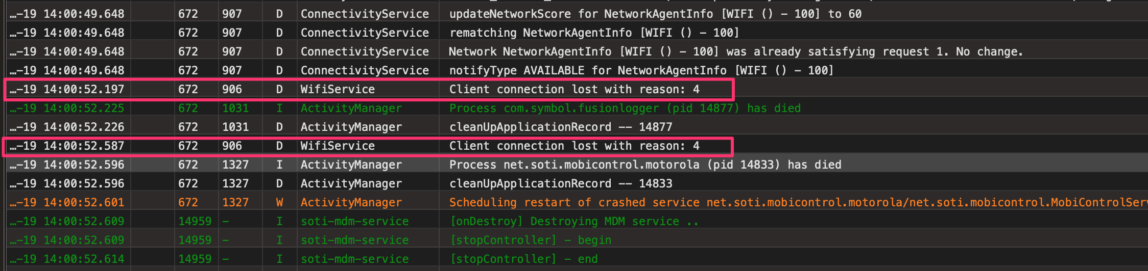

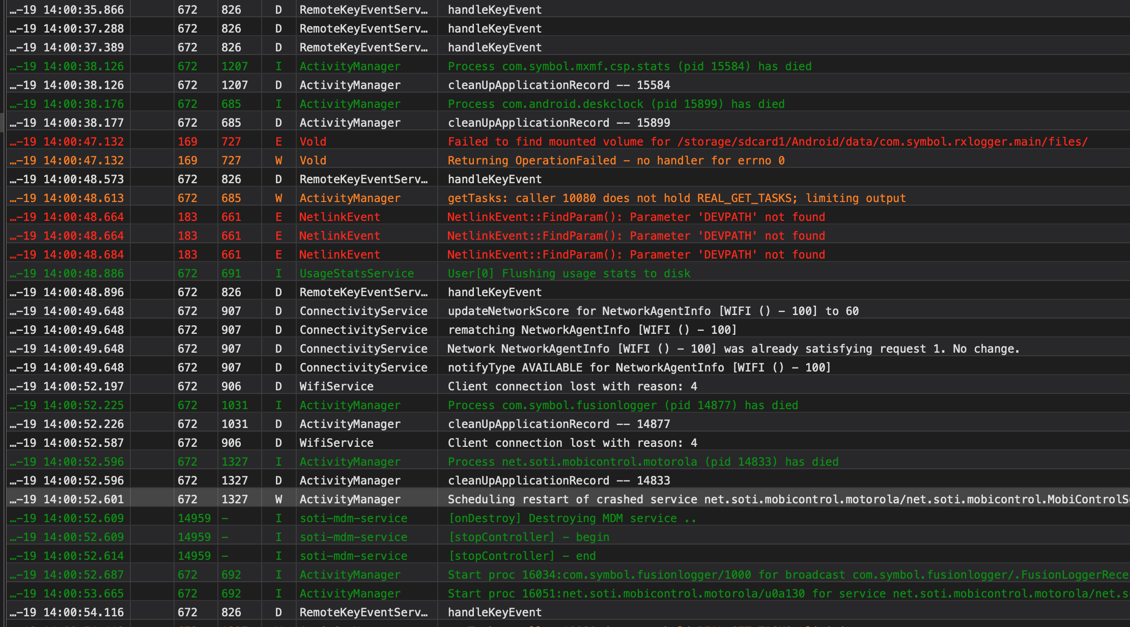

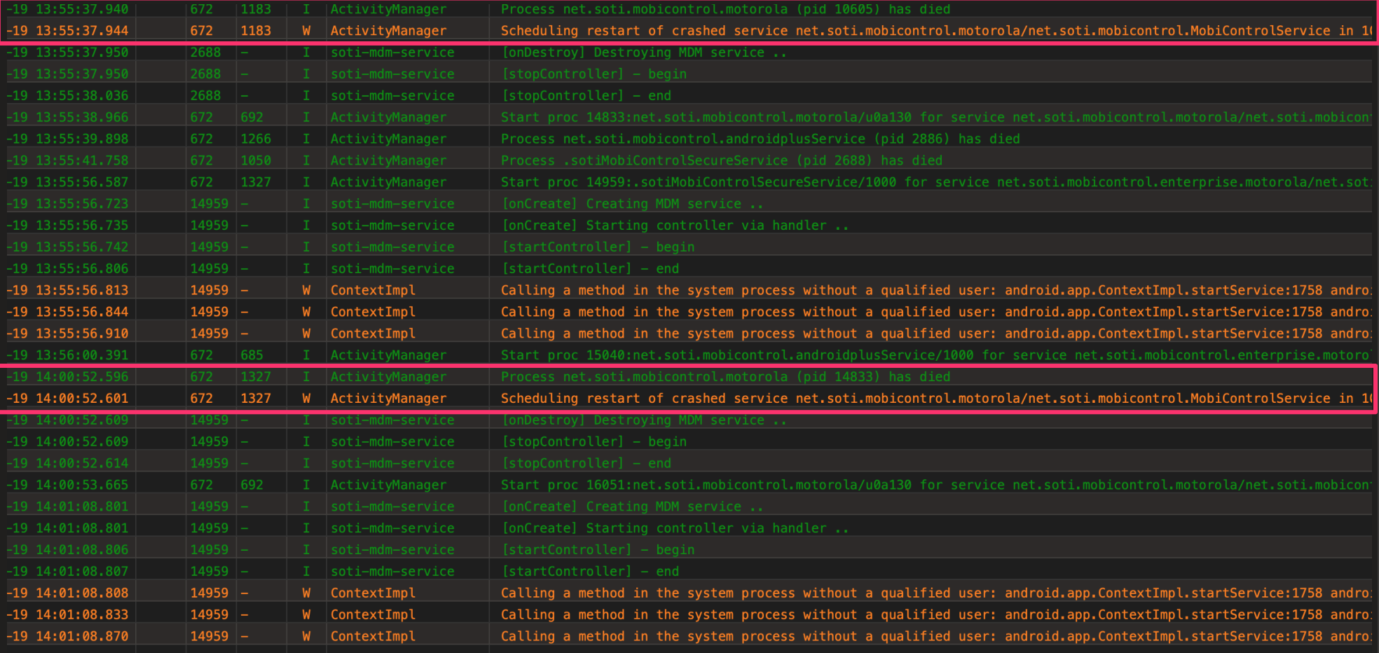

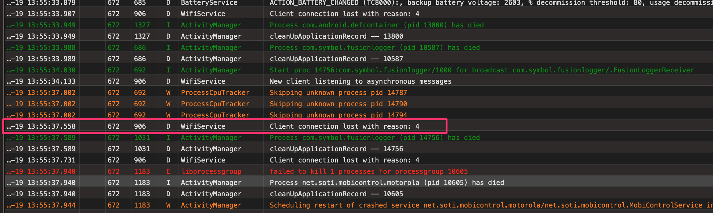

In this example we see two disconnects (1:55:38 and 2:00:52)
I can trace these to the System logs captured by RxLogger, where I can see the corresponding SOTI service crash at 1:55:37.944 and 2:00:52.
I was able to consistently map this in the logs confirming that every instance of the Disconnect + User Mode + Connect signature in the server logs coincides with this service crash at the device level.
I'm now compiling multiple instances of the the device logs capturing this issue to see if I can discern any common log signature pattern happening immediately before each one the service crashes. I have not found anything concrete yet but I do see regular instances of this Connection Error
Here is a more complete snippet of what the logs look like during the event:

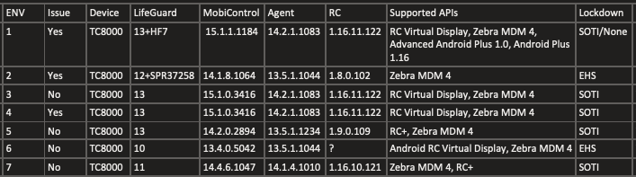

I have been trying to establish a pattern between different TC8000+SOTI environments and have been tracking the following variables to try and determine if there are any commonalities. I haven't found anything concrete yet.

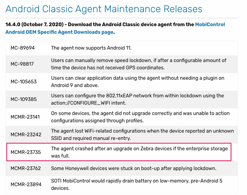

I'm seeing two common behaviors here, potentially a RAM issue (lack of it / memory leak) and an issue with connectivity. Internally the connectivity issue does point to an environmental issue. Meaning using separate networks such as 4G / unrelated WiFi network results in a change of behavior.
One thing to note is there are a lot of variables and no concrete common pattern right now. Therefore I suggest if you haven't already, then raise a Support Case via support@soti.net / support.eu@soti.net. Then link this post and work with our Technical Support Specialists in order to fully understand the problem and drill it down.
Physical reproduction of the issue is important, along with network logs and full verbose logs on the MobiControl side. Ideally RXLogger / ADB Logcat / Wireshark, on top of that the MobiControl Database is ideal too.
We'll message everyone affected for their case numbers where applicable and then will see what can be done to get this moving efficiently. If you're missed out and you're affected by this or very similar, then please reach out to me through the private message system.
This is a widespread problem liable to impact any MobiControl + Zebra TC8000 environment.
We have at least 3 cases open on this issue and opened a 4th one yesterday I believe, as the reports continue to come in. That combined with one additional environment that we're still confirming and then Uline and Scansource listed in this thread brings the total to at least 7 different end customer environments that are affected by this.
I tend to agree that there is a memory issue of some kind although I think it may be a storage issue and not necessarily RAM. The TC8000 is limited in both categories relative to most other Android devices under management so that could make sense.
The connectivity issues do not appear to be network related. They are the byproduct of instability of the SOTI agent that eventually crashes and relaunches on the device. This is perceived as a connectivity issue when observing this from the management console since frequent connections are being made. However, after pouring through the logcat output and other rxlogger logs on numerous affected devices it is clear that the agent service is crashing and restarting, often incessantly, leading to disconnects and reconnects at the MobiControl server level.
It's not clear if this is an underlying SOTI problem or a Zebra problem but people buy MobiControl because they have Zebra devices and there is a very strong partnership between the two companies so I would hope you could get together to get this figured out.

looks similar to an issue i have with TC70 & TC56 as below so keen to see what the outcome is
The TC70 has the same core architecture of the TC8000 so I am not surprised to see the issue popping up on that device model as well. That would be the first time that I've seen it reported on Atlas device like the TC56 however.

Hi All,
Sharing an update regarding devices that have low RAM and are affected by V14 Agent's increased RAM usage. There are a couple of issues raised for Zebra devices internally, which mainly cover TC8000/TC75 & TC700H. The Product Management team is aware of these issues and are working on how best to address these concerns.
In the meantime you can try the following as a potential workaround (The ultimate purpose is to reduce a device's RAM usage):

One thing we have seen, that I did not see mentioned is This problem does not occur on our TC8000s running Android 4.4.3 but only on the ones running Android 5.1.1. We are going to downgrade a device and test to see if the problem remains. Not an answer or even a very good work around but maybe a clue as to where the core problem may be.
