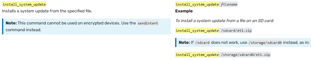

  • If you have the .ZIP of the firmware, send it to the device via a File Sync Rule and use the "install_system_update" script to install it: Script Commands for Android Enterprise: Managed Devices (soti.net). You may need to request the .ZIP from the OEM.

But it appears that the "install_system_update" command cannot be used on encrypted devices (AE DO).
