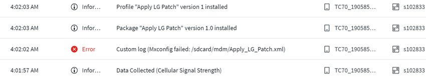

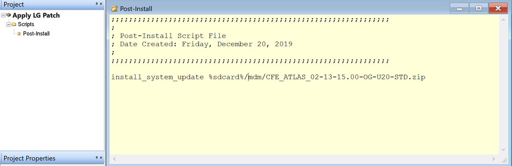

I am trying to update our TC70x devices to the latest Oreo LG patch. I used file sync to get the ZIP on all the devices and then scheduled the script (install_system_update %sdcard%/mdm/CFE_ATLAS_02-13-15.00-OG-U20-STD.zip) to install outside of production hours. When I woke up I saw that this failed. I went to one of the devices and just sent the script through the script button on SOTI and the device updated fine. So I am not sure what I am doing wrong here.
Something doesn't add up here. The failure is related to an mxconfig script and not an install_system_update script. Its almost as if you have two packages being assigned with different methods for updating the OS. install_system_update will trigger it directly with an intent pass whereas you also seem to be calling an mxconfig script somewhere on XML that was potentially StageNow generated MX. Whatever you're doing seems to be redundant.

I went back and looked at the package itself and I think I found the issue. The project I have pictured above is Version 1.1, while I still have the package set to use version 1.0. In version 1.0 I was using MX to move the file, this was before I figured out how to use File sync. SO now I am using File sync and updated the package, but never switched it to the new version. There were a few weeks in between this happening so I must have over looked it. I have reassigned it and hoping it goes well tonight.
