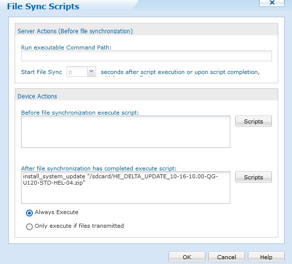

New SOTI customer here. I have enrolled a few Zebra TC8300 Android mobile computers and I'm trying to push OS Updates to them with file sync and then run post script:
install_system_update /sdcard/HE_DELTA_UPDATE_10-16-10.00-QG-U120-STD-HEL-04.zip
The file is transferred, but the script doesn't install the update.
The same script works if I just "send script" afterwards like this:
What am I doing wrong?

The formatting looks correct. Do you see any errors in the device logs in SOTI after the Sync is complete? What OS version are you upgrading devices from? Are you going from base A10 BSP 10-16 U00 to LG120?

I'm upgrading from 10-16-10.00-QG-U106-STD-HEL-04.

Try inserting a "sleep 20" line in your post-sync script before "install_system_update" to allow file sync to process. This is assuming that the devices are currently on the 10-16-10 BSP for Android 10 and can receive the lifeguard 120 update.

"sleep 20" did not work.
What finally worked was to put quotes around the path & file name.

Rafael, the device is currently running 10-16-10.00-QG-U106-STD-HEL-04. I'm trying to upgrade to 10-16-10.00-QG-U120-STD-HEL-04. The "UG" was a typo. The file transfers to the device, but the post script does not install it. If I do a "send script" using the same script as used in the file sync post script it installs the new version. I tried to explain that above. The first screenshot shows the send script that works. The second screenshot shows the file sync post script that does not work.
The devices will take the upgrade. I've done it with the "file sync" and then the "send script" commands using SOTI MobiControl. I've also done it with Zebra StageNow.
