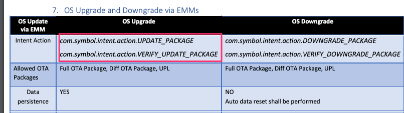

I've given this some more thought and am now assuming that you're trying to work around the fact that the Helios (SD660) platform devices like the TC52 and TC77 have a new version of Recovery Mode that has sub-menus asking for Upgrade/Downgrade as well as another prompt for Diff vs. Full update and that new Recovery Mode doesnt cooperate properly with the install_system_update script that could be traditionally used with Zebra Android devices. If that is the case I would suggest going down the StageNow route to generate an XML file for processing the update (as a .ZIP or .UPL) and then use the mxconfig script for kicking off that XML. It appears that there is an Intent that can also be leveraged, although I think this is more intended for the EMM providers like SOTI to integrate with their scripting. I would imagine that we would see a newer version of install_system_update at some point that works with this next generation platform of devices from Zebra.

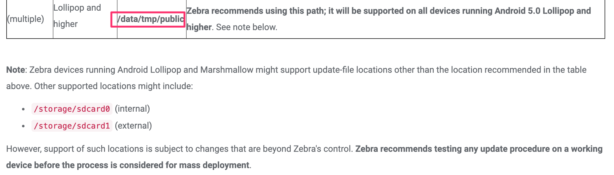

An according to this link you may want to use /data/tmp/public/Patches for the path in the UPL file.
http://techdocs.zebra.com/stagenow/3-3/csp/power/#os-update-file
